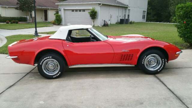

Hi guys, recently got a lead on a 70 LT1 Corvette t top. Car has been sitting for about 25 years in Northern California back yard under a tarp. Appears the block is wrong. Not sure if the tank sheet is there yet. Going to look at the car tomorrow. Carb and intake are present. I know it’s a bit of a shot in the dark but any clue on what the value of it would be given the wrong motor and needing a restoration....
Thanks in advance.
