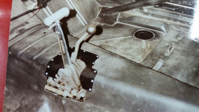

I posted another reply on Team Camaro. I didn't cut much of my floor. Picture is when I had the Ramrod in it, but the hole size is the same.
Freddie

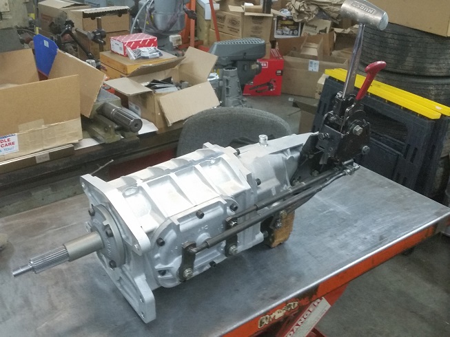

Here is one of my Super Shifters mounted on my new AutoGear N24. You can see that the shifter is mounted much higher and a little to the left.
Freddie
