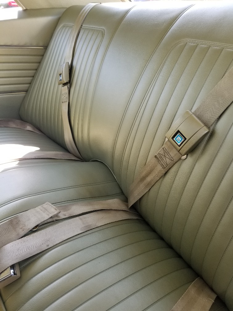

I'm curious what you guys are using to safely haul your kids or grandkids around in your old musclecars. Booster seats require shoulder harnesses and that's hard to come by for rear seats in 1st gen Camaros. My daughter is 5 and I need to decide whether to buy a particular seat or add different rear belts. Thanks.

Yeah, that was an idea except our 68 only has lap belts in the front. I've considered installing shoulders up front but the interior is Ivy Gold which is a challenge any way I look at it.
