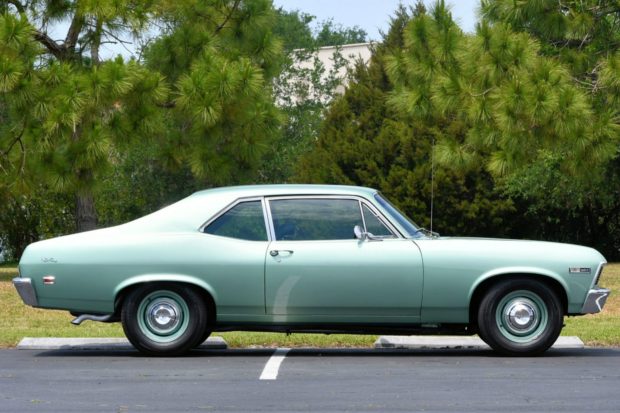

68 L-79 Nova
https://bringatrailer.com/chevrolet/nova/

watch the video attached in that BaT ad, scary!!

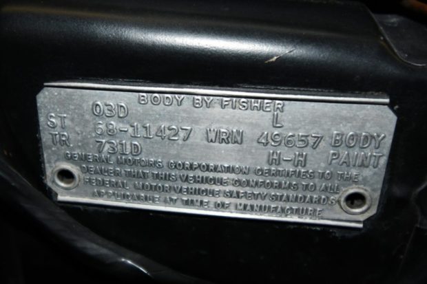

Scary reckless? Nice car, if it’s real.
Thoughts on that engine stamp and very fresh looking trim tag?

If that Tahoe rolls into the right lane, there would be no more L79, and most likely, no more driver

Originally Posted by L78M22Rag View Post
Thoughts on that engine stamp ?
I think the "EP" stamp looks a whole lot more faint than the "V03I6"
Bill Pritchard
I've seen a few like this before.Look how deep the "VO3" side is,as if they leaned heavily on that one side while stamping.

Build sheet shown in the description is not for this car. Color shown as Cranberry Red, a 1972 color.

Code 75 started in 1970.Good catch.
