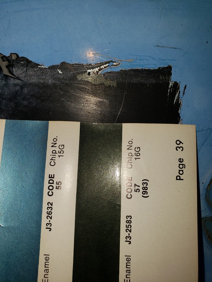

Hello folks-
I am getting some conflicting information that i want to try to clarify. NOT calling any one out at all! Some folks have been very helpful providing info info but they conflict each other.
My question is for a Fathom Green 69 Camaro SS396 is the tail light panel body color, or matte black?
one VERY trusted source within this group and others advised matte black, which i have always thought, and had read in another VERY trusted source's books.
The confusion is there is a 69 SS396 survivor belonging to a GREAT member on the site with a body color (Fathom) tail light panel.
I am still trying to establish some validity to my 69 Camaro actually being a SS396 so i scraped some of the robins egg blue (yuck) off the tail panel and the results are below in photo.
So matte black, or body color...which can i hang my hat in?
Thanks folks!
Chris Slawski

Interesting, so you think your car was an SS 396 originally?
Old 05-11-2020, 05:24 PM
Posts: 36,633
Thanks: 3,506
AFAIK, all 1969 396 SS Camaros had the matte black rear panel. All other Camaros had body color (SS350, COPO, Z/28, RS and STD). Only one exception was the 1969 396 Pace Car convertible. That would be white (body color)
The tail panel and black out area would have a 60% gloss. There is a debate as to the percentage of gloss, but definitely not a matte/flat finish.

Charley and I have had a debate on the % of gloss. I would paint it 60% gloss. Obviously as you polish the blackout paint it will become glossier over time. I would not paint it flat/matte. JMO

I THINK it is but it is a CA car without original drive train, but does have some tall tale signs. So as i have said before, it will NEVER have the provenence of a car like L78 Fred has but it would make a really fun driver.
I use matte as a generic term not specifically matte. I am more concerned for body color vs "not real shiny" black tail light panel.

I'd paint your tail panel black too.

The way I describe it is, it's shiny but not shiny enough you can see your reflection. Lacquer straight out of the gun can sometimes produce the same effect..Joe
