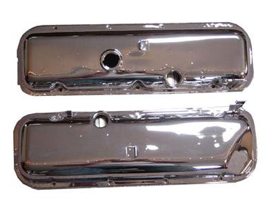

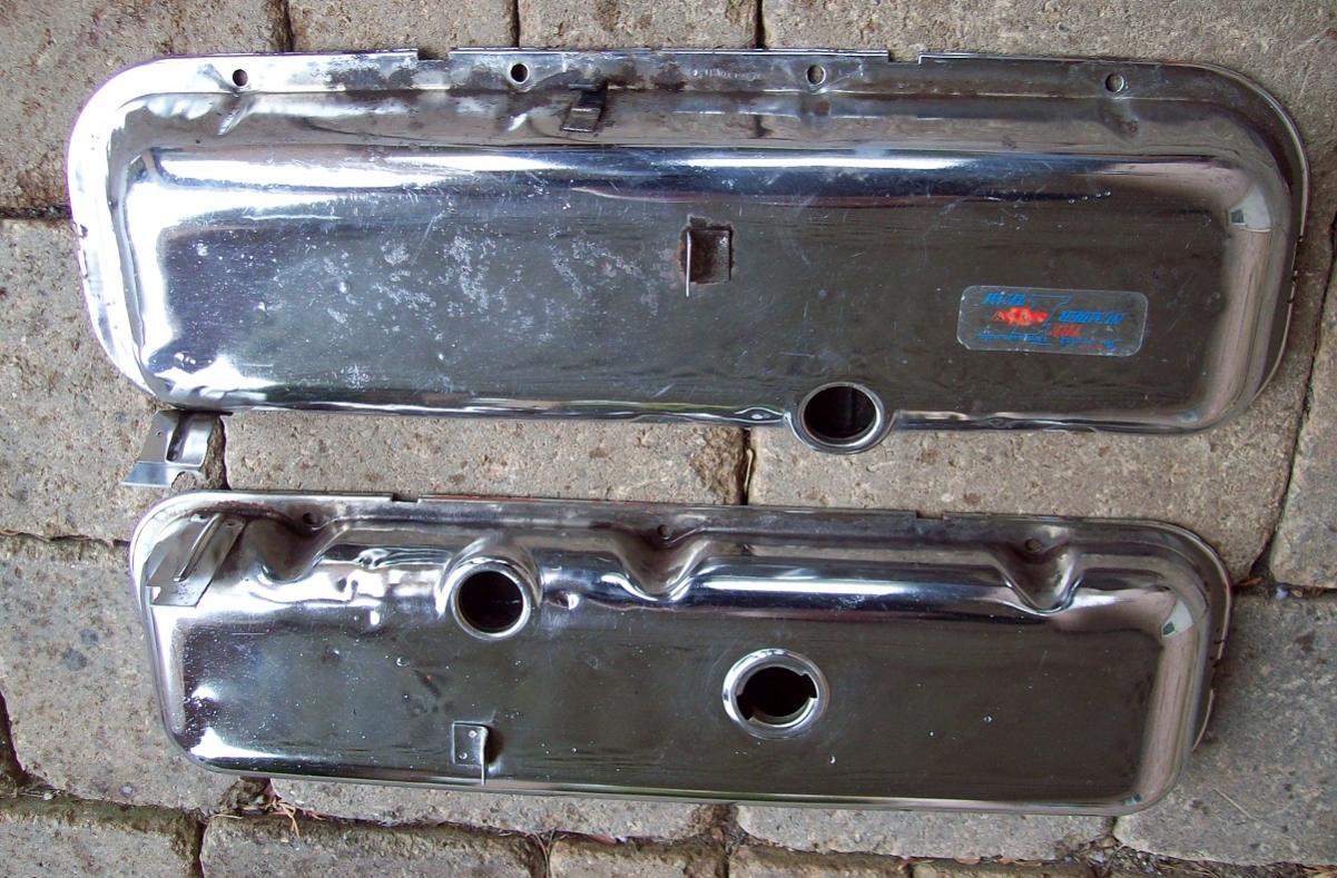

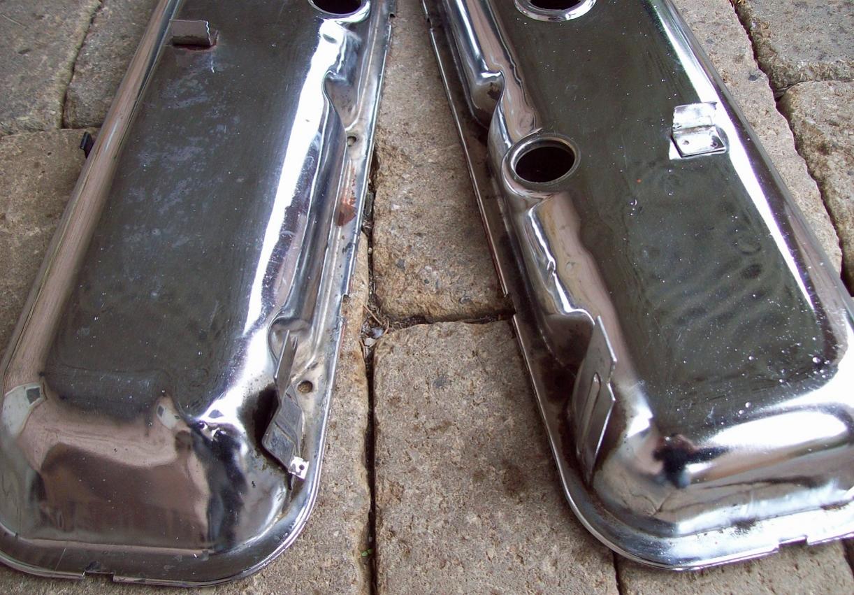

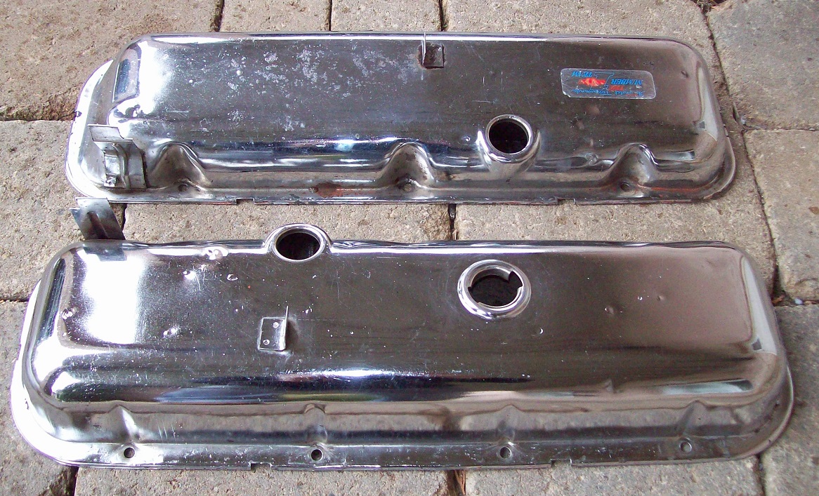

Arrow 1969 Survivor Big Block Valve Covers Camaro Chevelle COPO Nova Corvette 396 427
Nice decent set of Survivor Valve covers with no breaks or dents.
I believe these will fit 1969 Big Block Camaro Chevelle COPO Nova Corvette with 396 or 427.
UPDATE >>> NOT Correct for 69 Camaro or Nova as drivers side plug wire stand is not in the correct location. Also not 100% sure for Nova.
$250 USD plus $35 Shipping from Canada.
Paypal "Friend"

FYI. The driver side plug wire standoff is in the incorrect location for 69 Camaro.
Thanks Steve you are right,
went over to the Crane Corvette Photo Files and Camaro is located past that first bolt hole. So Valve covers are correct for the cars mentioned except the Camaro.
Also I could not verify Nova as they have no samples as photos.

69 Nova & 69 Camaro driver side are the same, so these are not correct for Nova.

Thank you guys so exclusive to 1969 Chevelle or Corvette then.

Corvette would have slant on lh side
I got to stick to 1970 Chevelle Parts LOL.
So Chuck these are 1969 Chevelle Big Block Only Then?
if you look closely one side does have that slant (Drivers Side)

68 down had a less pronounced slant,69 up much more pronounced

pic

Probabaly Impala application as well.
