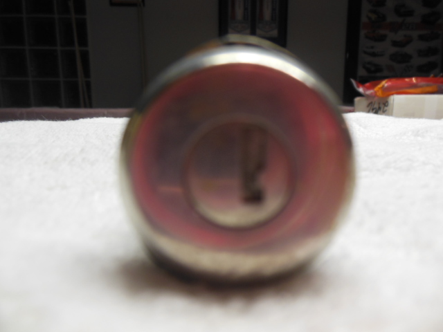

here is a original trunk lock the doors are the same in looks
Old 01-26-2020, 12:43 PM
Join Date: Aug 2003
Location: Chicago Suburbs
Posts: 12,342
Bingo!

I’ve rebuilt mine and salvaged the OEM notched flapper and used it with a new cover. PITA to take apart, but the results are perfect.
I agree, pet peeve, straight slots look like ...well they’re just wrong.
