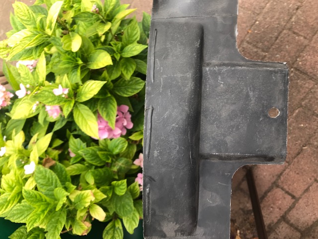

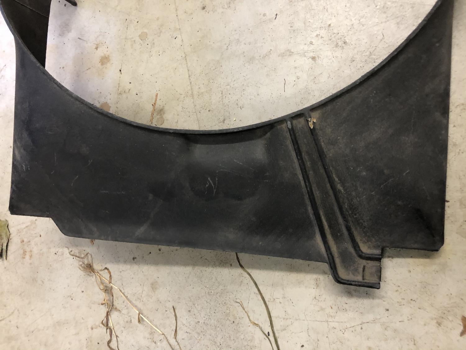

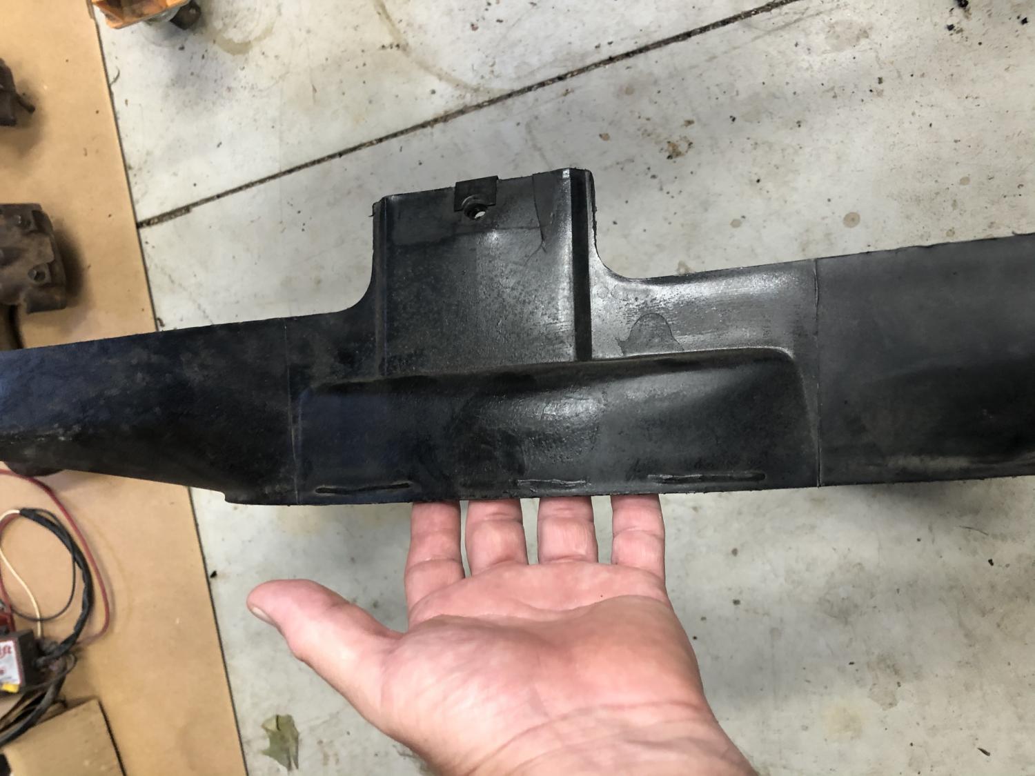

Just picked up some parts from a ‘ junk collector’. How do you tell an original 69 BB fan shroud from a repo? Thanks

Was hoping for some advice where to look so I could post some detailed pics. Looks like maybe it had a spray bomb used along the top?
But here is a few

I am assuming repo.. until proven otherwise.. It had 1/4” of dust and I just wiped it off without cleaning

GM part #??

It's likely the GMPD service replacement. Originals did not have the 3 horizontal beads at the center.

I have an NOS one With tag and an assembly line unit. The only difference I see is what William pointed out - the 3 casting ribs are on the NOS one but not on the assembly line one

^ agree, that's been my experience too; those three casting lines / ribs.

What is it dated?
Dated next to pt. # in the middle of the circle
Three “worms” on top were later over the counter parts

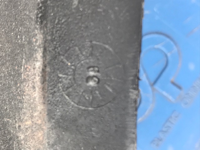

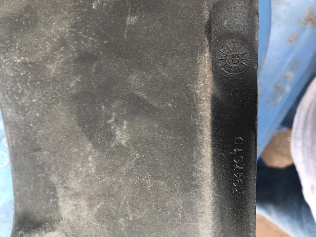

Old 07-25-2020, 07:26 AM
parkbrau's Avatar
parkbrau parkbrau is offline
Join Date: May 2007
Location: Stuttgart, Ge
Posts: 556
Thanks: 189
Thanked 159 Times in 66 Posts
Look on the passenger side, inside outer wall of the shroud. Mine has the part # and a round clock emblem. See pics. looks like its dated 12 68??? or 12 88
