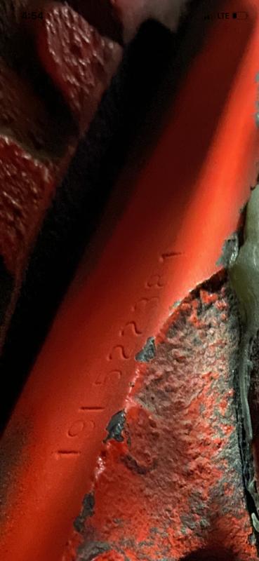

Block stamps may be ok, need to get the paint stripped off the pad. Also need pics of the carb, alternator, distributor, radiator. Each one would be $1000+ to correct. Rear axle?
