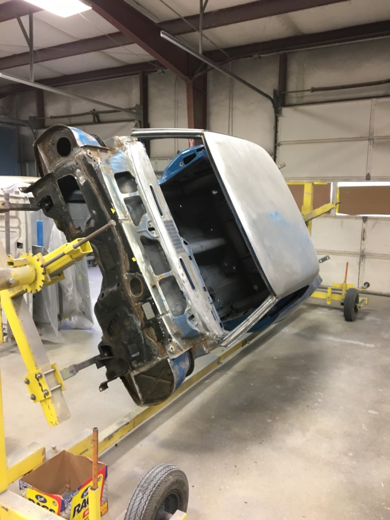

Getting my Daytona Yellow Z/28 ready for a trip to the body shop where it will soon undergo a complete rotisserie restoration. Knowing a fair bit about how the factory paint process I am still unclear on a few things that I would like to know more about? I am hoping to recreate a factory-style paint job and I do have a few application questions regarding cowl paint, stripe blackout in the front plenum, and underbody paint that I could use some help with? I could also use a refresh on trunk paint and the best products to use? That being said I will look for an old thread I recall on that subject. (Mike D'Angelo)
When the body and floor work is complete, I plan to have the entire underside epoxied/sealed in a grey primer. It will then receive a satin black finish blown onto most the lower floor pans in towards and back to the tunnel/s and a dusting of the rear frame rails up into the rear end tunnel & back towards the rear valance. The underside of the tank will be left with exposed sealer/primer, as will the majority of the forward trans tunnel area. When the firewall is ready for paint, it will be based in yellow at the same time as the jambs, rear wheel wells and cowl plenum being sprayed. It will then be followed in satin black with some of the lower front floor sections still having some exposed grey primer showing from the edges of the front seam in towards the tunnel. The idea is to then blow the firewall paint back into the tunnel area and recreate that spattered grey/black finish found on many factory survivors. Just to be sure, I thought I better ask the following random questions before attempting to do this right:

Attachments - The Supercar Registry theRuns.jpg rotisserie .jpg GrayPrimer.jpg Flat.jpg

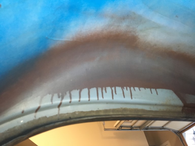

Some pics of the yellow paint found under the firewall black and the original overspray found under the car today. There are some of the processes I am planning to recreate when it's painted in a couple months from now. I'm hoping I pull this off right as I want it being as close to factory as possible.
Yellow body color found under the black firewall paint.
I always thought the black was atop body primer. Wrong!
Yellow overspray on the trunk pan.
This blew in as far as the tank straps and cnter ridges.
Even the insides of the tank straps got dusted from the opposing sides.
Here you can see the wheel houses and rails were painted before being undercoated. They were also dusted after the fact.
It looks like the diff tunnel even got a deliberate shot of color sprayed up inside the tunnel? Direct over grey primer it would appear.
