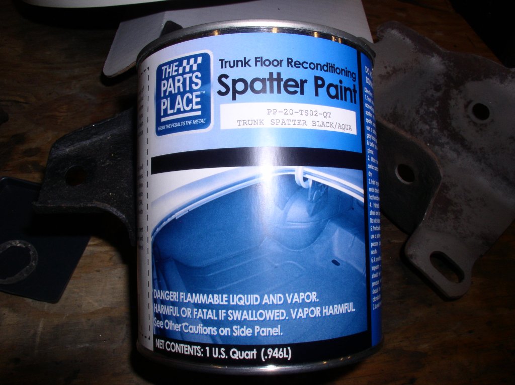

Has anybody used this product? Opinions? The body shop purchased it for my 69 Camaro...Thank you, Joe

Have you opened it up to see how it mixes and what the particles float like Joe. I got a quart of the stuff Heartbeat sells and I'm going to open it here in the coming days to see what it's like. In a few weeks, we'll spray it out and test it through a shutz gun before we put it to use.
Curious if the two products look alike in the quart can.

Haven't looked yet. The can says do not shake but to gently stir. It also says to shoot a base colour first...Joe

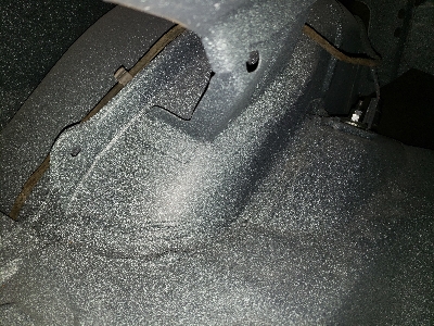

Here ya go Dave. As a side note, I used the original unrestored trunk finish in my 05C Norwood car to duplicate efforts in my 03A Norwood project. In doing so, the "Black" appears to be a very dark gray, so I mixed the SPI epoxy base to match...then worked on the setup and my technique to approximate the spatter size and density.

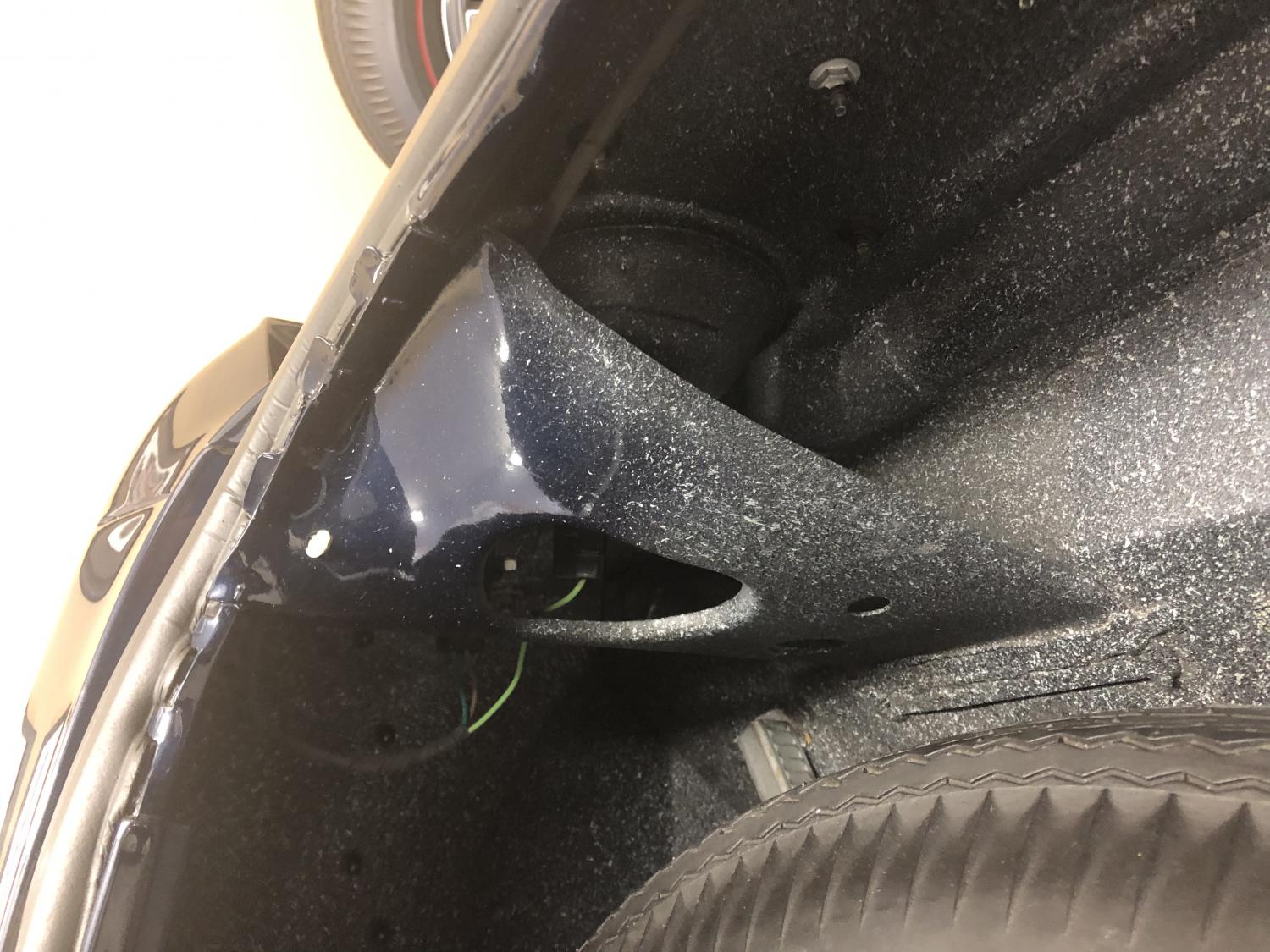

My Z has the dark epoxy base coat and then the gun was set up to spit an aqua spatter. Turned out great
Picture makes it look metallic! Looks better in person

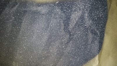

I found a picture of the can of green used on mine. It is PPG shopline code 43816. Looks a bit minty on the can. On top of the dark base it doesnt look very green
Picture is of the paper used to cover what was not painted
