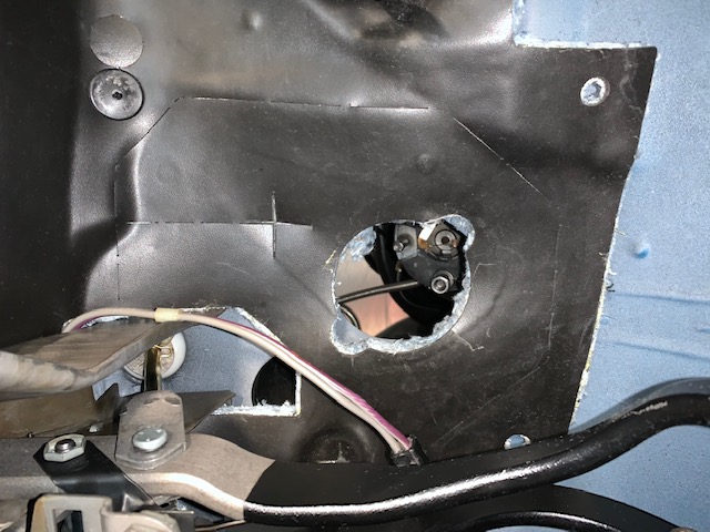

When installing the firewall pad, did the factory have a punched out piece of the pad around the steering column firewall seal or was the steering column seal bolted to the firewall behind the pad. I see some of the reproduction firewall pads have a perforated triangle around the steering shaft hole and I see some without it. I have not found a unmolsted car to verify this on. Any insight would be greatly appreciated.

I just pulled the column from my car & the column was bolted to the firewall & the pad was next.....Joe

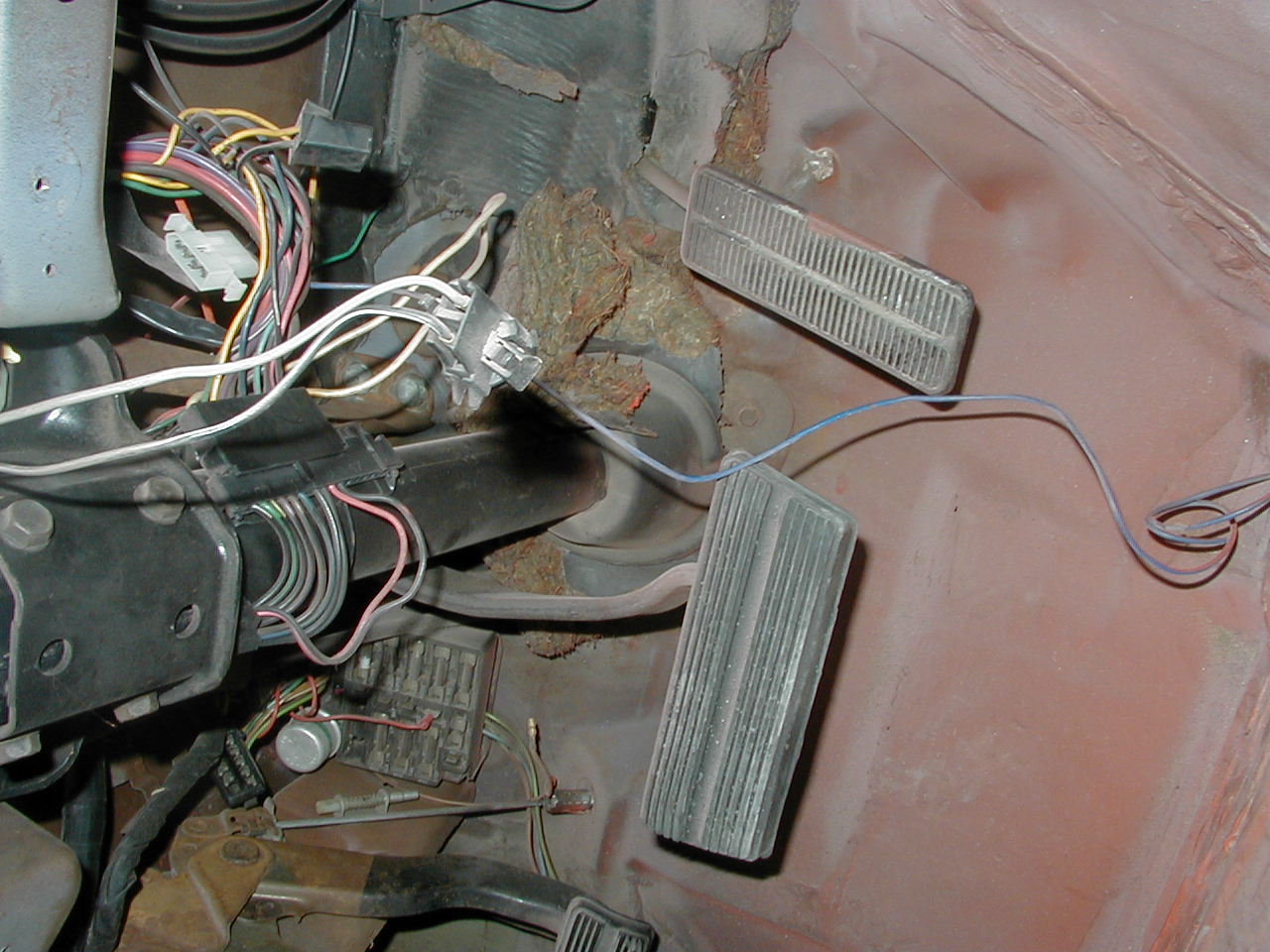

I took a look at my reference pics, it sure looks like the pad goes underneath the columns rubber boot, so I would say the hole is small, same diameter as column. My .02
When doing my resto, I only cut a small round hole for column to go through the pad, I did not remove that large section, no pics of that of course

Thanks for the pic. It almost looks like the large cutout was separated from the rest of the pad and then re-installed? I'm looking at the area just to the right of the brake bracket mount....the flap for that section is folded down exposing the jute backing.

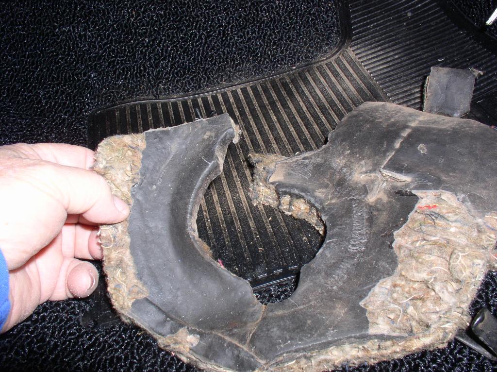

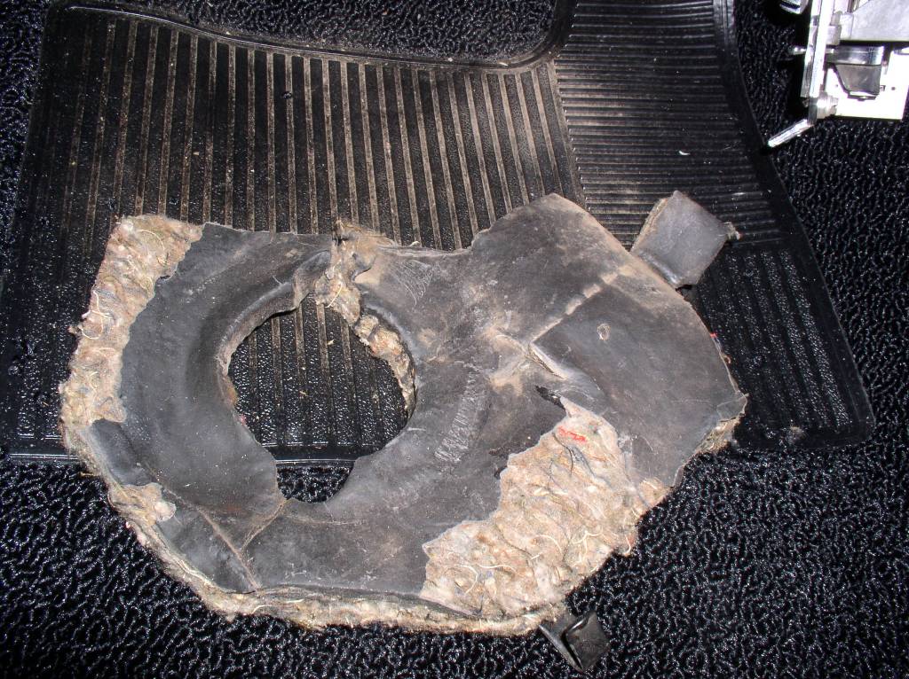

Here's some pictures of my original. It's split at the top...Joe

Old 12-13-2020, 06:08 PM
R68GTO R68GTO is offline
Join Date: Aug 2017
Location: Minster, Ohio
Posts: 1,296
Thanks: 2,208
Thanks Joe, that tells the story!
