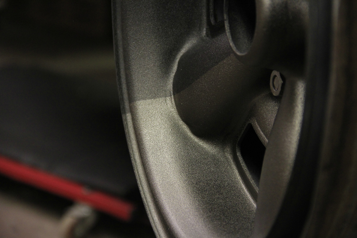

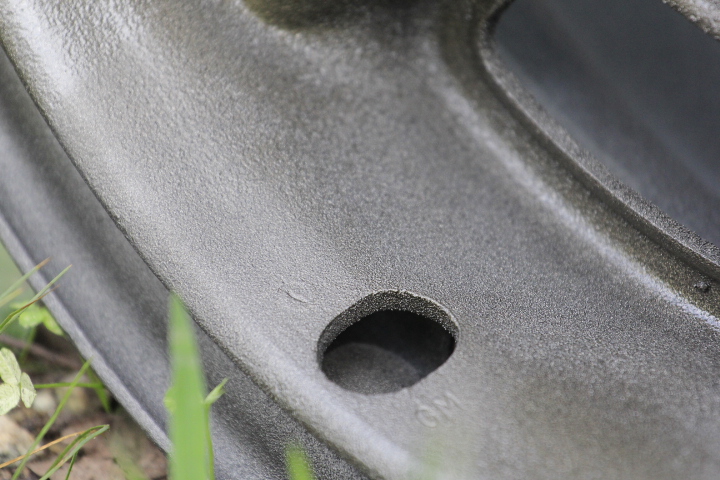

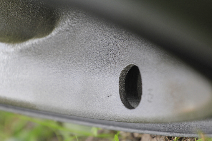

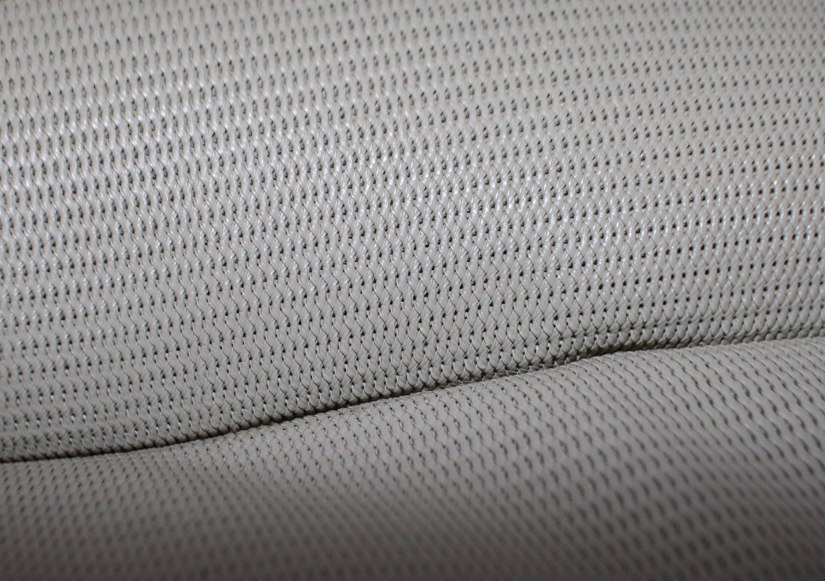

This is my brother's car my dad is restoring and I guess I am going to paint it.
Numbers matching car he bought in the late 80's to replace his 73 LT/Z28 which was bought new at Stott Chevrolet in Tryon NC. - Quain Stott is a current IHRA pro mod guy. (Stott also sponsored Jim Little's ZL1 powered 70 Camaro formerly owned by our own Kim Howie)
anyway here are some pics...
