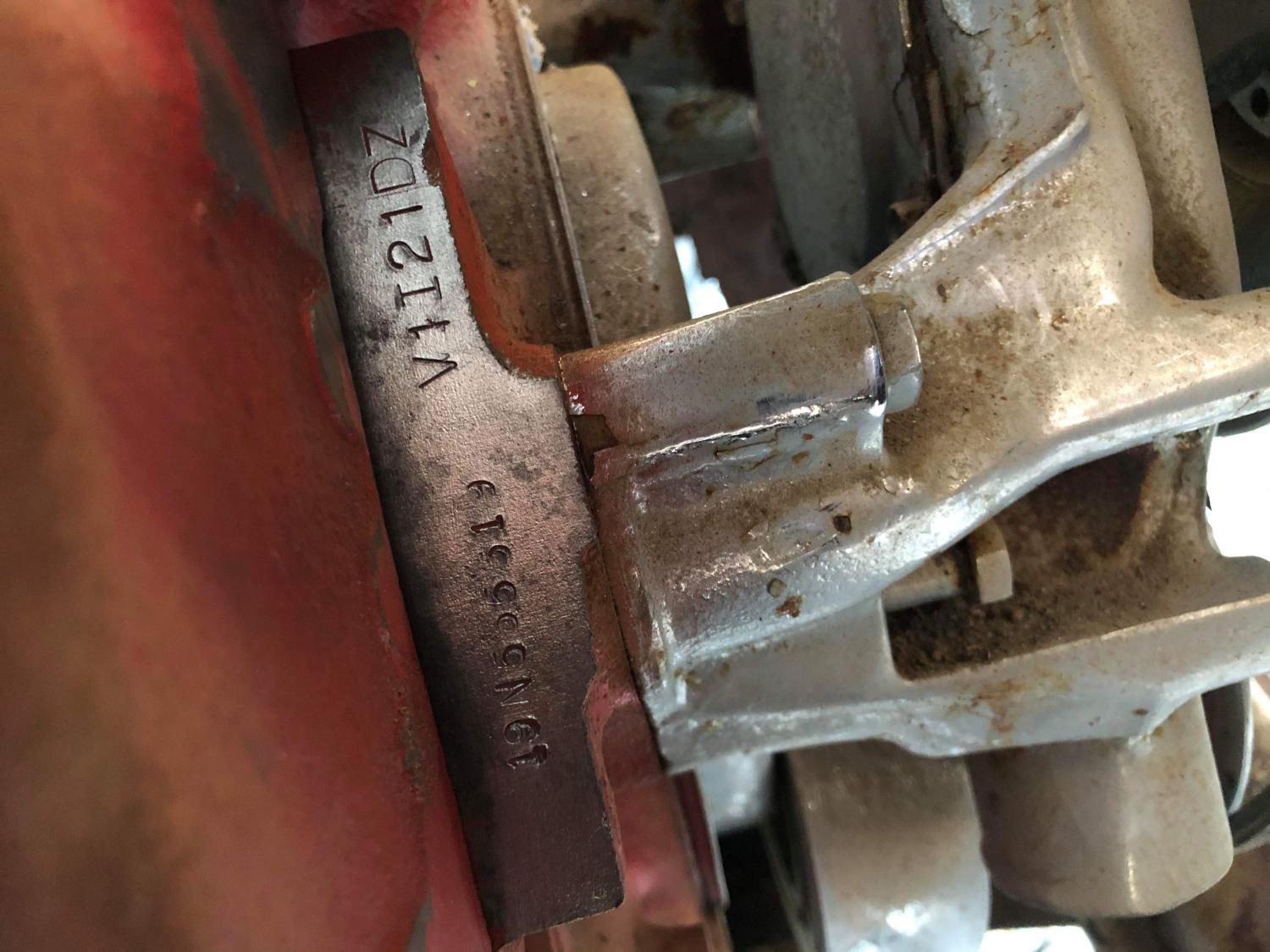

Can you guys give me some opinions of this dz engine stamp? Early car so it has the vin there as well.

Matches another Nov 21 DZ stamp.

----Faint but good broach marks!......Bill S

Broach marks are there admittedly - but I don't know that I have ever seen a stamp that is that deep or that well defined that was ever deemed to be an original one..
There is also some ghosting and evidence of another stamp under the first few characters - plus the DZ suffix itself looks to me to have been stamped with a larger font than the rest of the other characters - but I admit I'm certainly no expert of any kind and maybe there are known reasons or exceptions for all of what I see here as oddities..
Hopefully others will chime in here and add more comments..

Was that from a Daytona yellow RS?

RE: The V, 1 and 2 ... looks like that ghosting is from the bounce after the first initial strike. As they line up very well. Danny
Yes it was

Stamping looks legit to me. I have another 1121 stamping that looks exactly the same.
