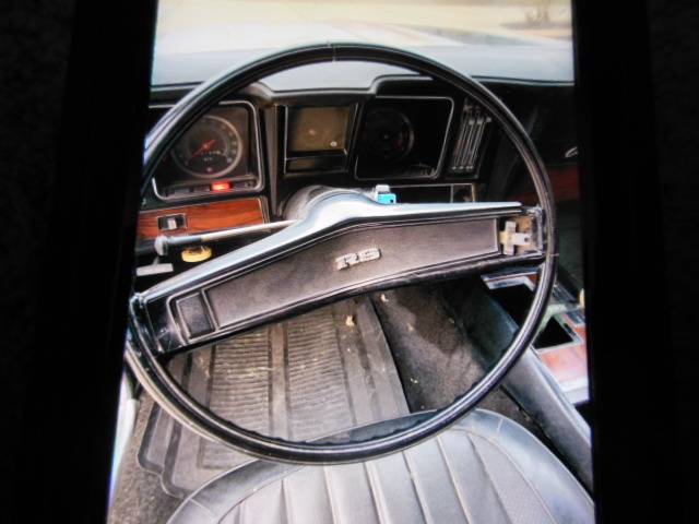

just bought a 69 rs/ z28 with custom interior has the rosewood dash both sides and rosewood consol but the standard steering wheel just has a black center no rosewood is that correct

Whats the code for your interior on the cowl tag?
If you have custom interior the shroud should be rosewood.

If you have the Z23 option with grab handle & stainless trim on pedals, you should have wood grain shroud.

ok just wanted to make sure it is a early build and parked since 1985 and this is how I found it

trim tag is 712

http://www.camaros.org/interior.shtm...pecialInterior
