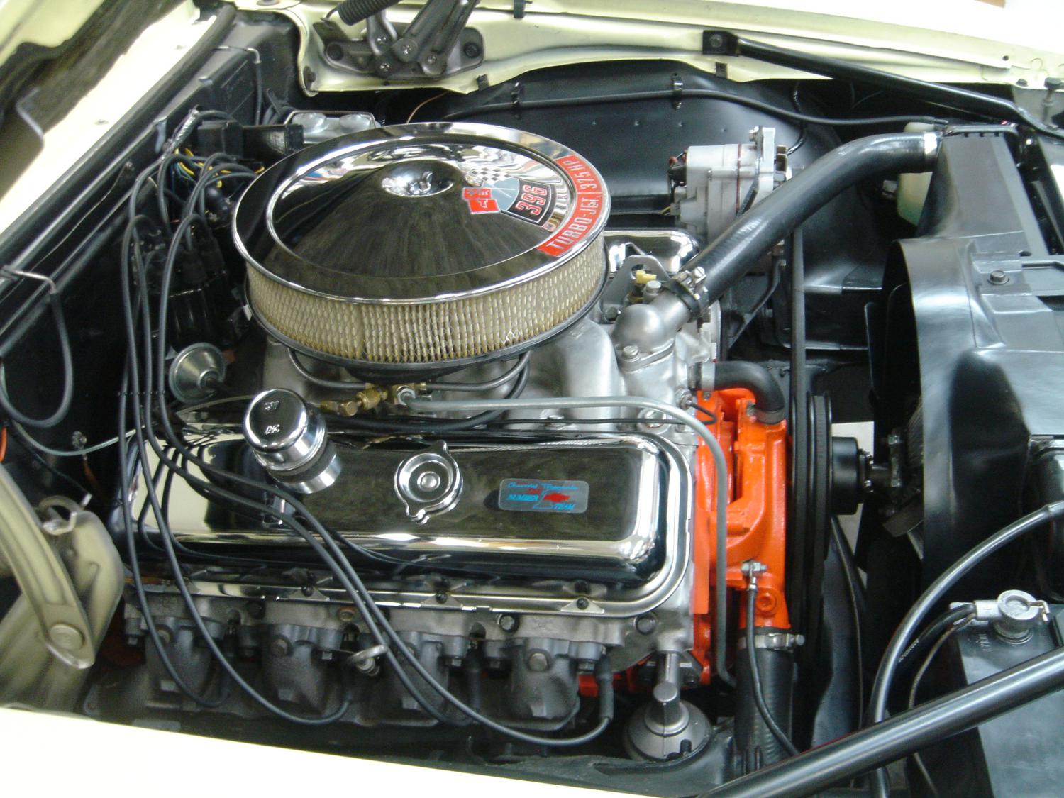

Looking for thoughts about reproduction fan belts. Are they good quality? Do they look correct? Any other thoughts? Thank you, Joe
