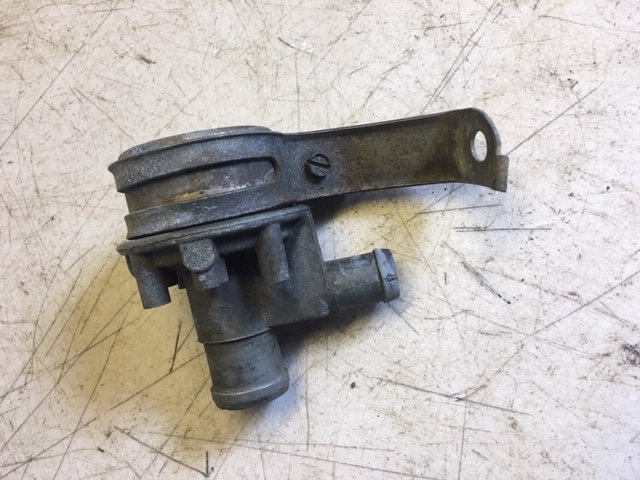

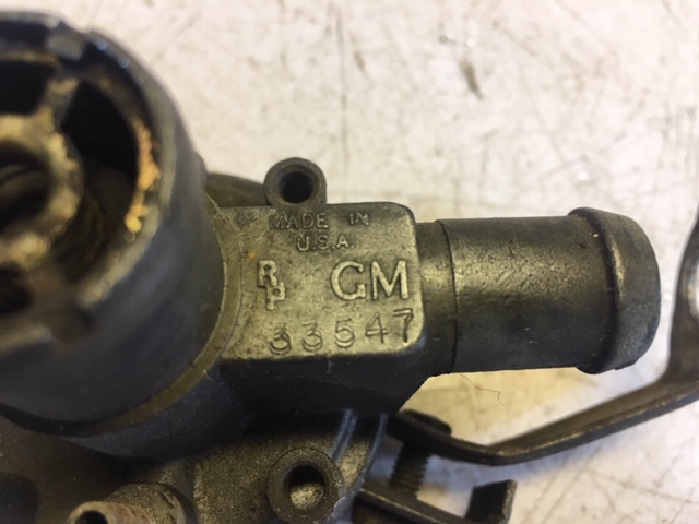

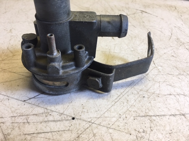

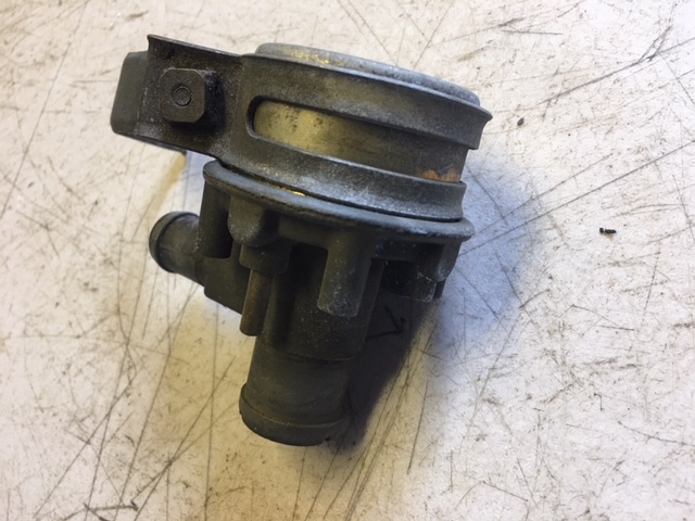

Anyone know what application this bracket on the diverter is for? Valve # is 33547 which seems to be for 66-67 BB Corvette, maybe others, but didn't the Corvette and Camaro have a small half moon cradle on the valve cover that took a Wittek clamp, not the bracket in the pic?

Don't know about other applications, but that bracket is used on '67 Chevelle L35 396, retained by the coil bracket bolt closest to the dist. It is NOT used on '67 Chevelle L34, which has the half moon bracket on the valve cover..

The valve assembly is part number 7033547 found in parts group 3.670
Says it fits '67 Chevelle and Camaro 396 except H/Perf
Not sure if it fits Corvette. I would have to locate my Corvette parts book to be sure.
