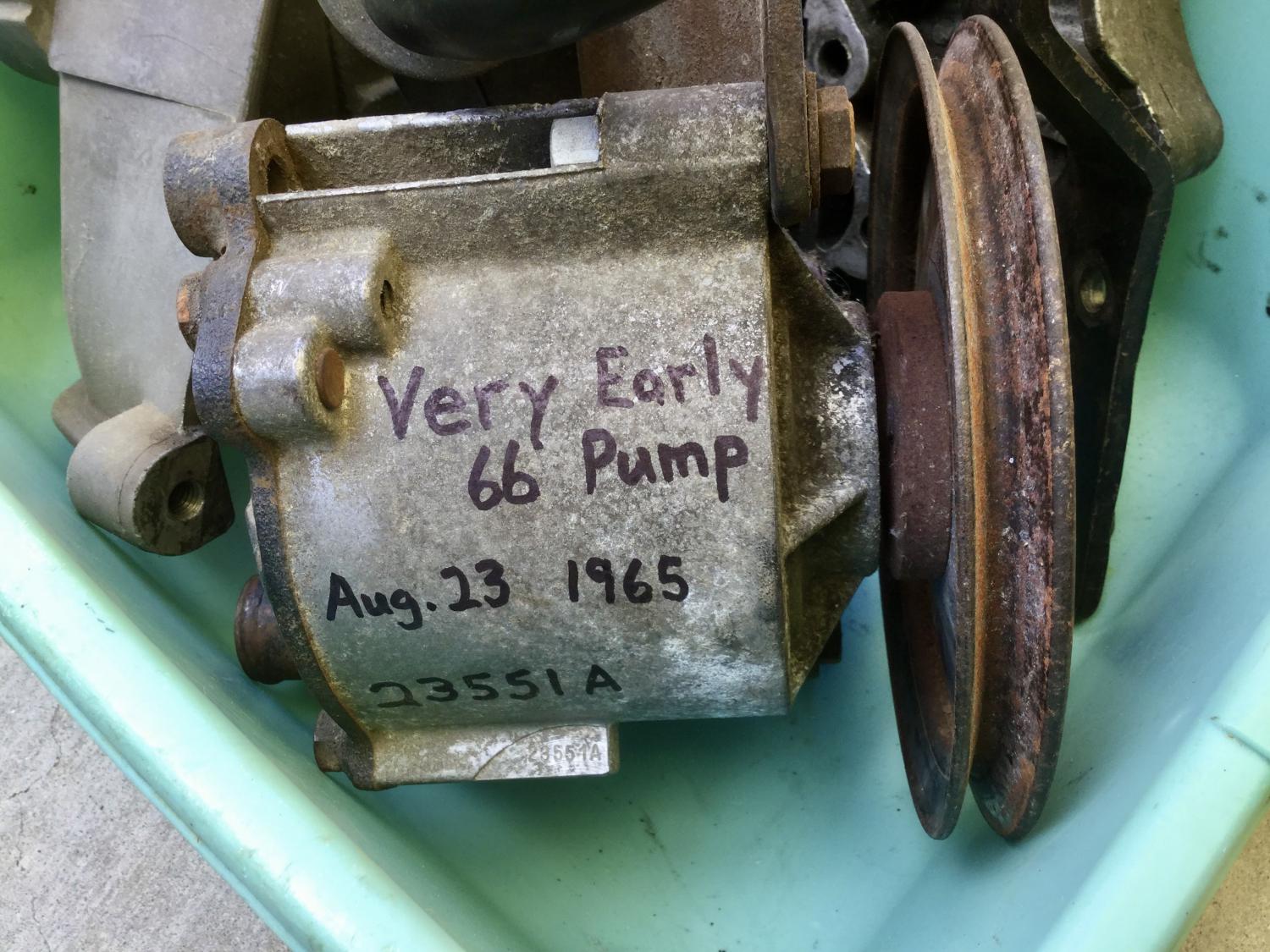

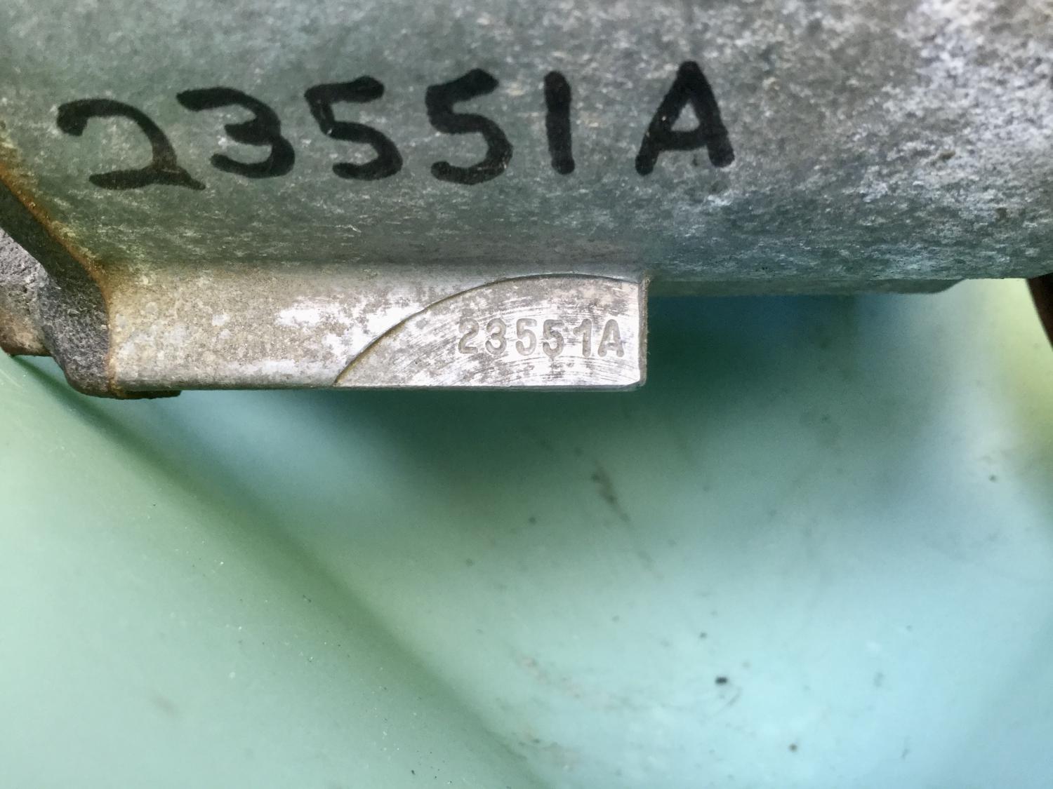

Default Early ‘66 pump
This Smog pump came off an early ‘66 GTO.
Chris.

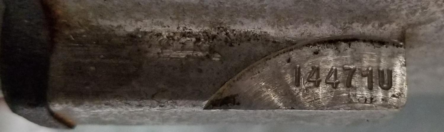

This is my '67 "06D" GTO pump date which is stamped in the machined area.

Grant,
Your stamp of 1447 looks to be May 24, 1967 which lines up with your car.
