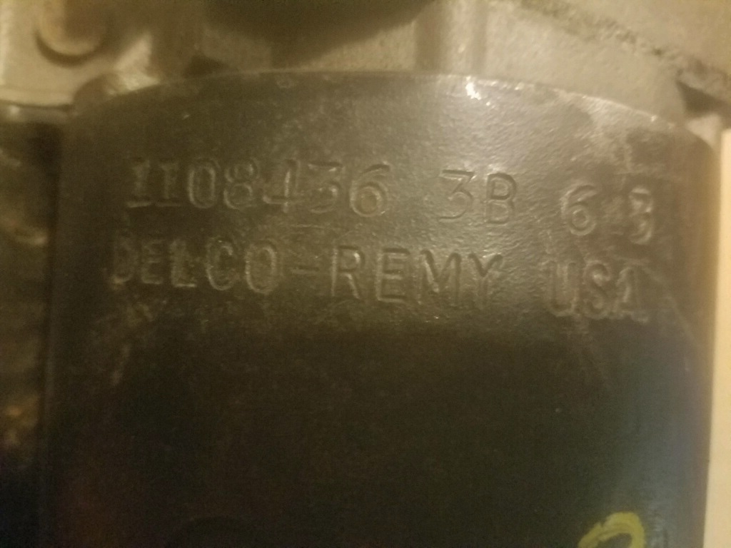

A friend just found one dated 3b63

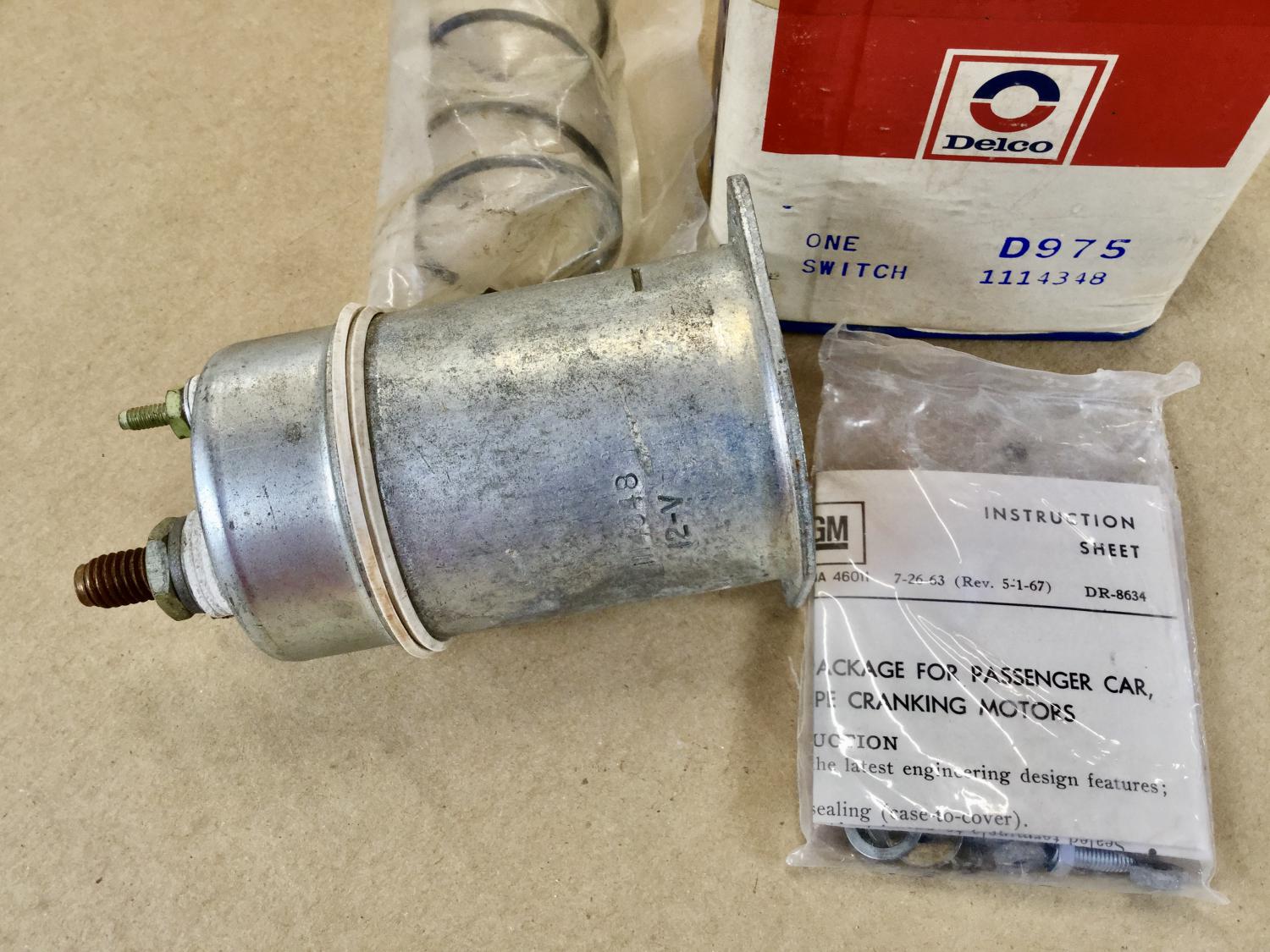

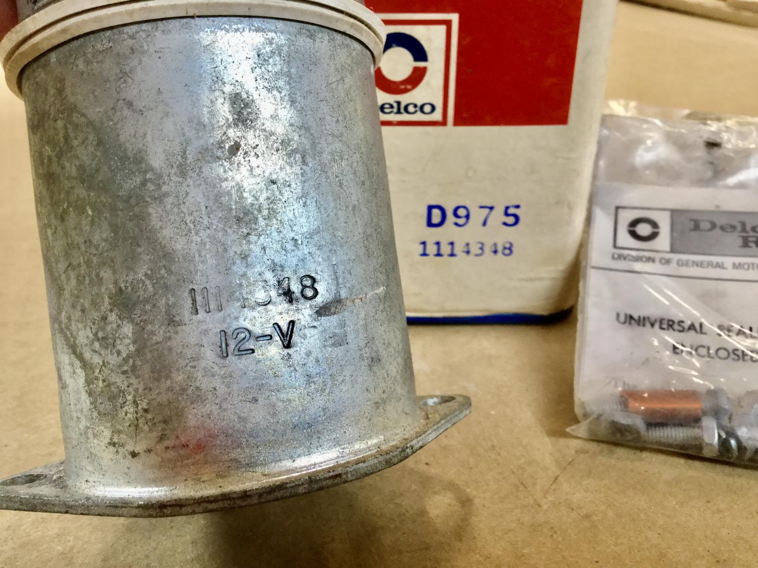

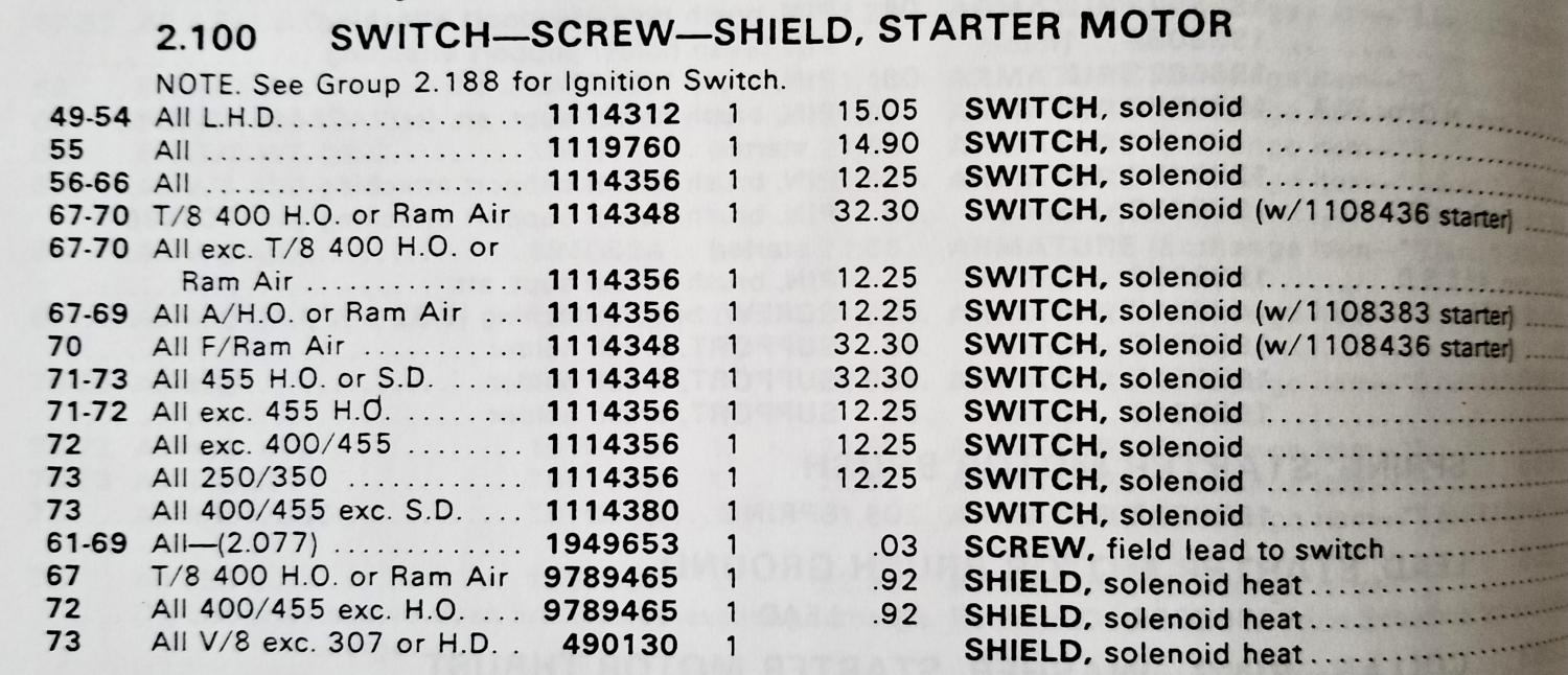

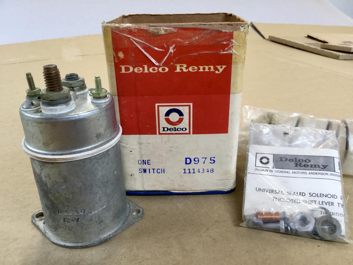

Here is the brutal Solenoid (Switch) that should be on these starter motors as shown in the MPC.
Solid steel construction. No Bakelite end as on the cheaper version.
I once owned several ‘67 GTO HO cars that had this “Switch”.
Tracker1 (06-10-2021)
