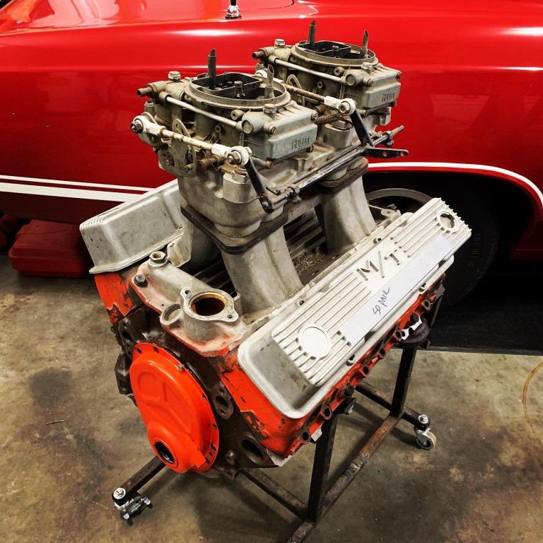

Can someone post information on dated tunnel rams? For instance what might have been used in the late 60's, early to mid 70's, etc.

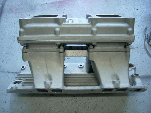

Cool Picture. Edelbrock made one before that -plenum was one giant square box.
Offenhauser and Weiand also made TR's in 1970-1973 era.
Most came out in the early 1970's.

This is a cool intake. Only one I am aware of that has different port sizes per runner- see pic.

Marlin, Those bread box TR1's were absolutely horrendous on the street and it takes someone with experience to set one up right and even then it won't run as good as a TR with a smaller plenum. Even Edelbrock pitched it after one year of production and went to the TR-2X and discontinued the TR1. It was a poor design to begin with.
A friend of mine put one on his 70's style street rod he was building and it washed down his cylinder walls after a summer of driving and he and his friend who set it up have been setting up these systems since the mid 70's. He wanted a challenge..and it beat him.
I would suggest the Edelbrock TR-2X, or better yet the Weiand or an Offenhauser-both have a smaller plenum than the TR-2X and are very early 1970's correct. Offenhauser had a very good reputation for nice running street TR's back in the 70's because they had the best plenum shape.

Ok, I like the 'Bread Box' look - but have heard about the washing down of the cylinder walls. I don't want to deal with that as it would certainly take all the fun out of this whole endeavor!
What are your thoughts on this one?
Offy Turbo Thrust

Your engine looks great.
Does anyone know the time frame on the two pictured?

Marlin it is period correct. All the Offenhauser TR's were available in 1970 and they never changed the design nor the lettering etc.
You can still buy them brand new from Offenhauser through Summit.
Most people who built these back in the day like Offenhauser best on the street-it was the right combination of plenums shape and size.
Couple hints-don't run a radical cam with a TR on the street. You need a cam that produces the most vacuum as possible to suck down that fuel air mixture. I have an R/V/performance style cam in my car from comp cams who helped me build the engine on paper.
Run the heaviest flywheel you can find and the highest gear ratio for torque at low rpm's and street cruising.
Run an electric fuel pump to at least start the car to prime the fuel bowls upon startup. I'm going to run a vintage Holley along with a mechanical pump and once it starts shut ff the electric pump.

<div class="ubbcode-block"><div class="ubbcode-header">Originally Posted By: Chandler</div><div class="ubbcode-body">Your engine looks great.
Don't worry about Stunkards picture of the Camaro. He won't mind.
</div></div>
1974 ish...
