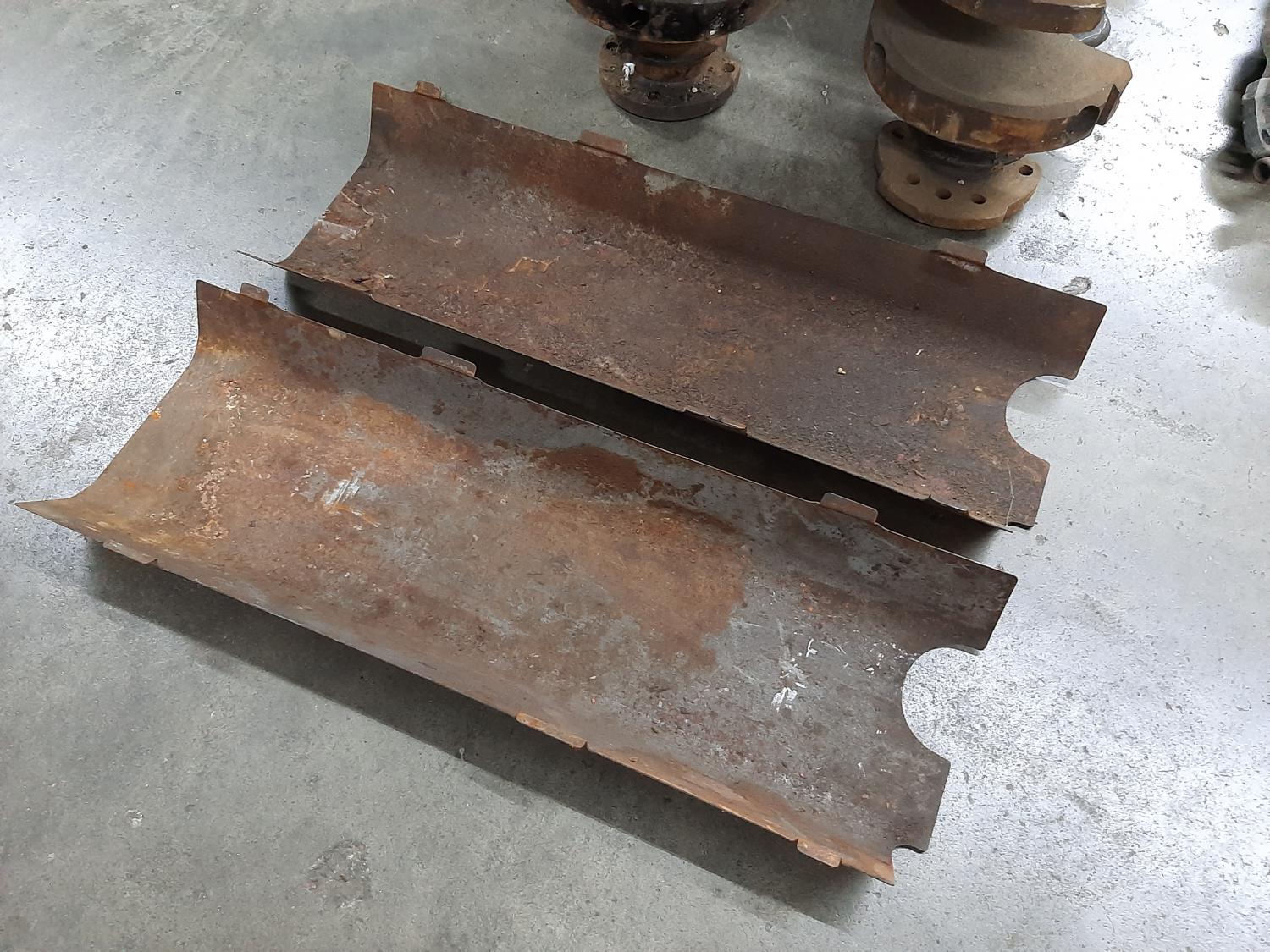

I found these today and bought them. If it wasn't for this thread I wouldn't have known what they were.
Freddie

Originally Posted by RALLY View Post
I know how you feel. Yes these just snap in place and have tabs on both sides. You will see thru the pictures when you find one. Good luck.
I used this GM intake oil splash shield on my 468 Chevy BB on the strip. These were great and another outstanding engineering idea by Duntov and Chevy. Used on the L-88 427-ZL-1 427 BB engines.
