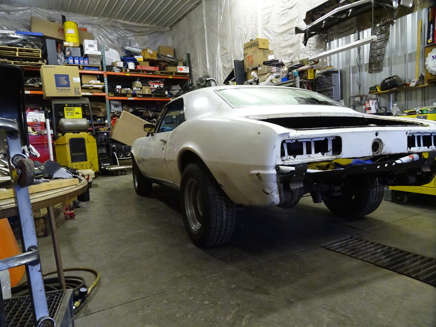

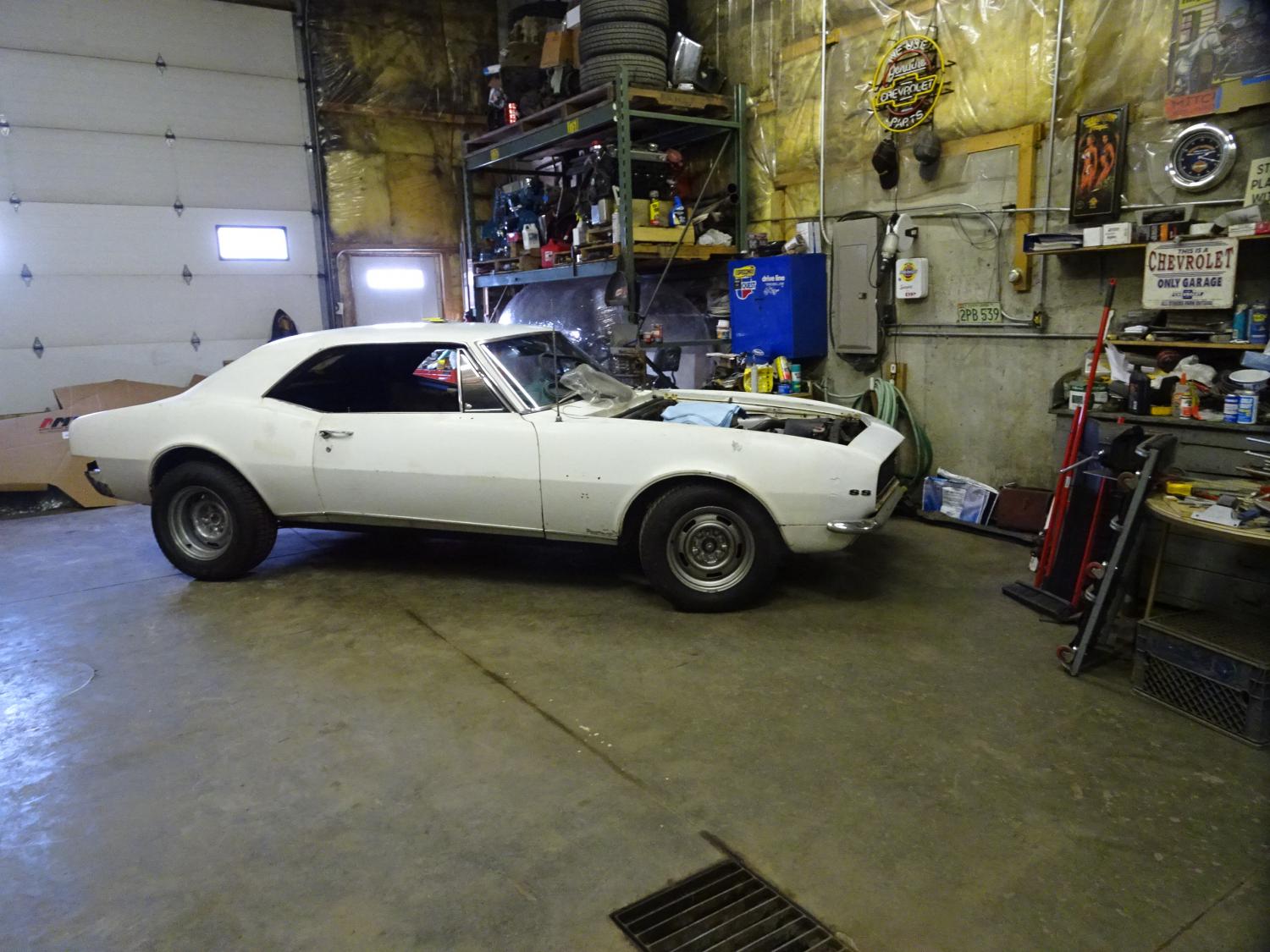

Hi Mark, that's a great tire IMHO. And his plan sounds similar to what I did on my barn find '69 a few years ago...
click here and check out post #16 for pics:
https://www.yenko.net/forum/showthre...rn+find&page=2
I put the stock 14X7 XT wheels on the front with 225/70R14 BFG Radial T/As and used the as-raced 15X10 rims on the back with 295/50R15 - worked and looked great, again, IMHO. All with the RWL turned inward.
Have fun with it!

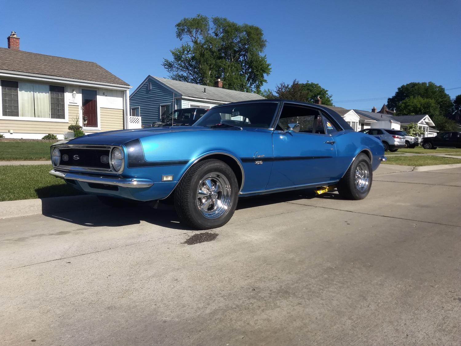

I have reproduction Corvette style rally's on my '67 Camaro. 15x6 front, 15x7 rear, with 215/65 front, 255/60 rear. They fit and fill the wheel opening nicely. The rears will rub the inside on a steep upgrade into a driveway, if I go in an an angle. Straight on and no issue.
If he is going black wall out, there are many tires with better traction ability than T/A's. I wish Rusted Tires had a better website with pics of the reproduction radials now available. I, and buddies, have had handling and traction issues with the T/A's and don't buy them, but that's just my experience.
I was able to attach a couple pics directly from the hard drive. Not sure why the back appears so high. I was moving it around with a floor jack and it maybe hadn't settled yet ?
Mitch
