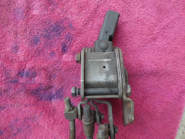

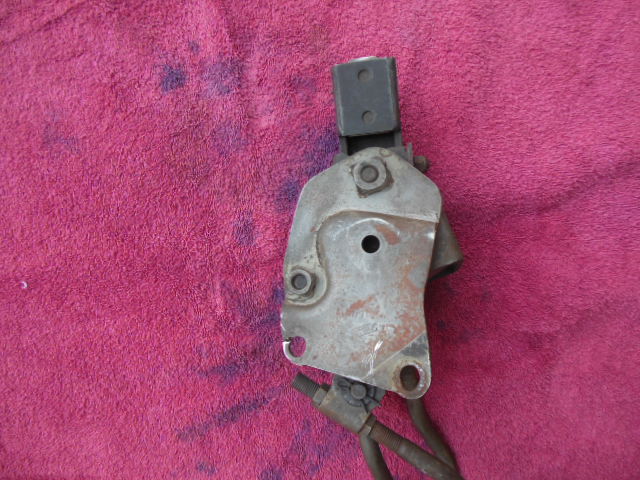

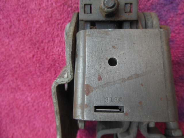

found this in a box of parts I bought trying to find out what it fits thanks

2nd gen F-body with Super T-10, looks like May of 1974 date...
Hope this helps... Crash

Would have been a Pontiac, Chevy used ITM by 72? What is the reverse rod number ?

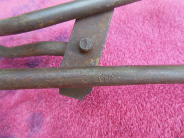

the reverse rod just has a S stamped into it the 1-2 shift rod has 493450 stamped into it

With those numbers and letter they are from a Pontiac Firebird. I have one just like it from a 1976 formula. However,I believe the 5619 rod is for the 1970-74 Z28 Muncie.
