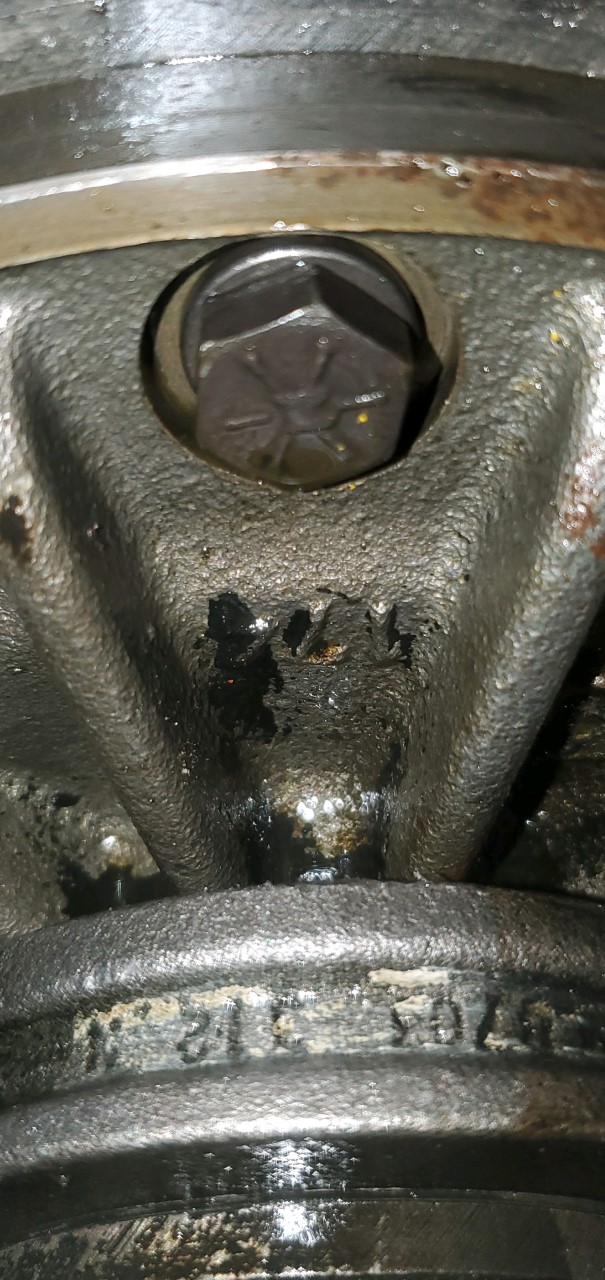

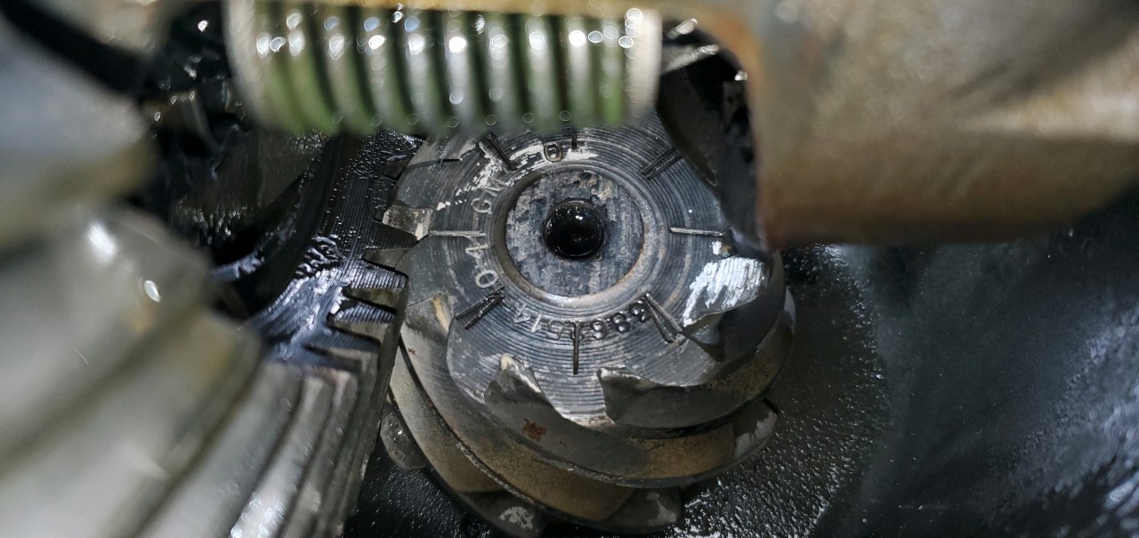

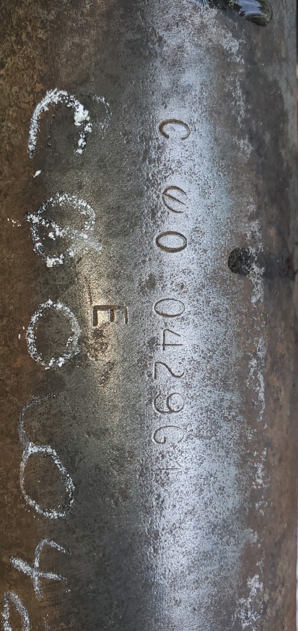

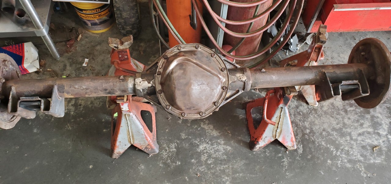

Looks like a nice 70-only factory 4:10 (COO)12 bolt for a Camaro or Firebird. Rare piece and the April 29 assembly date makes it applicable to most May-built cars. Asking prices are all over the place...last one I bought was $1000 about 5 years ago. (COO with a January build date). The market narrows a bit unless you can find someone local that will pick it up as shipping costs are not cheap. The real value is in the factory 4:10 code and date, so you would need to find someone who has an applicable car with an appropriate build date. IMO, $1500-$2000 range depending on how bad someone wants/needs it.

----I can imagine someone travelling a fair distance for this rare 12-bolt. Maybe offer to deliver part way to put a deal together.....Bill S

I agree with L16, $2,000 would be a good place to start.

Are the axle tubed welded to the pumpkin?...looking closer at one of the pics and not sure if that's crud build up or they're welded. If welded, IMO, that reduces the value for someone interested in the rear for a restoration.
