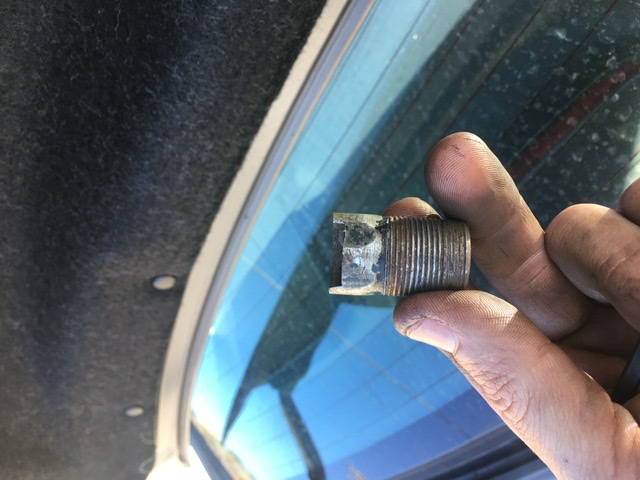

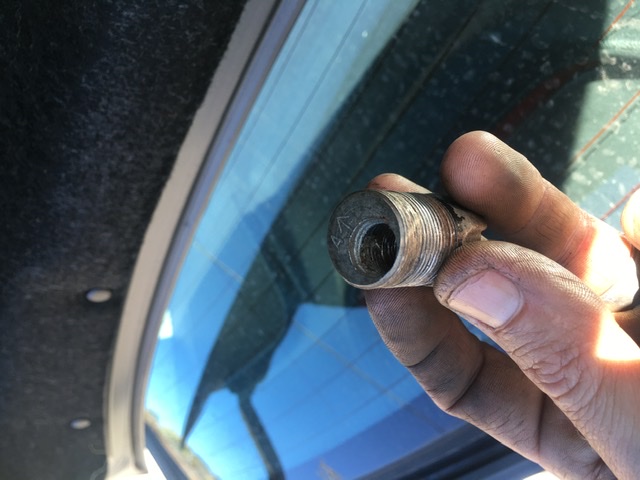

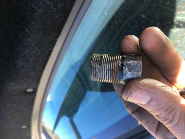

A guy that works down the road from me stopped by and asked if I knew what these lug pattern adapters were. He is missing a couple and is looking for replacements. I have never seen anything like them. Is anyone familiar with what these are and if they are still available?

Those are for Appliance aluminum wheels. I have changed some years ago,real pain. I did a quick search and found some under appliance wheel lugs under images.
Thank you very much! That gives me a place to start. I would really like to help this guy out.

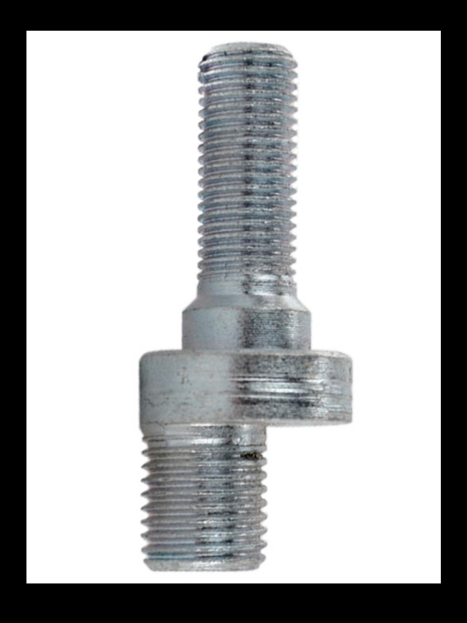

Roto Lug was the Appliance name, available Center style also Eccentric as below pics.
Try the Z-Car also Opel guys...maybe Lynn's bottom toolbox drawer?
Not Roto Lug but ceck out the offset studs as last pic, anyone here ever used these?
