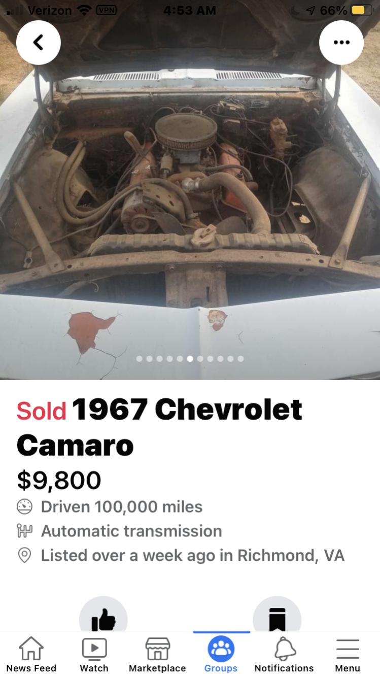

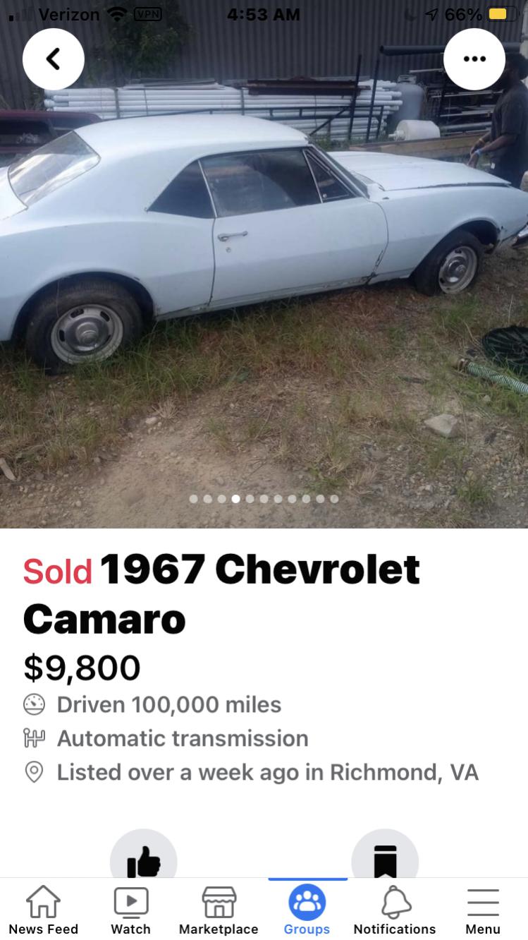

That photo was shown in a recent FB Marketplace ad. Unfortunately the car's VIN indicated it began life as a 6-cyl, so either the VIN or TT was swapped at some point.

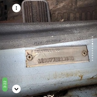

Here is the VIN from the ad.

VIN confirmed.. 6 cyl car.. car had an Ohio title
