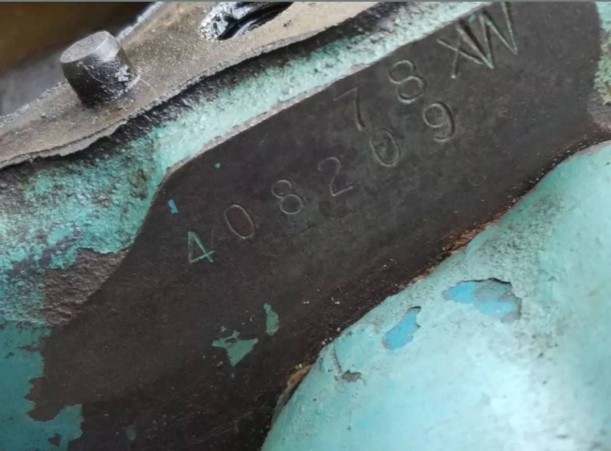

Looks like nice fresh engine paint. Pontiacs don't keep paint on the cylinder head exhaust port and intake heat riser areas for more than five minutes after first start.
Look at the different color under the chipped area.
...oh and by the way in this photo the cylinder head is missing. You're looking at a short block with the locating dowel visible.

This block stamp 78XW = 389 / 325 HP / 4BBL. / 4 Speed.
