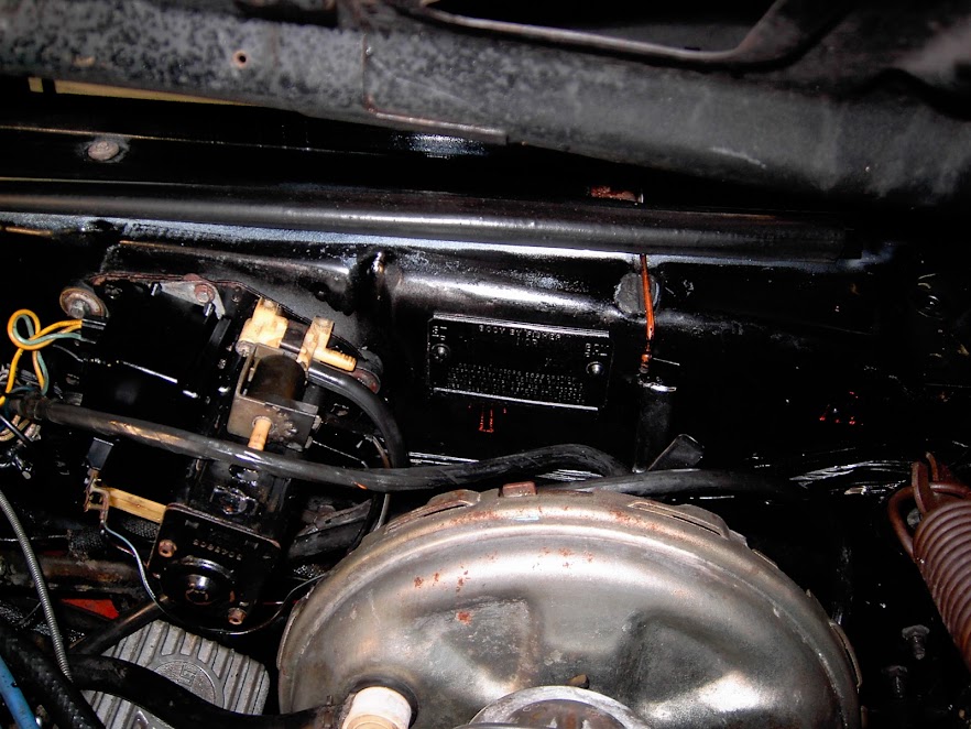

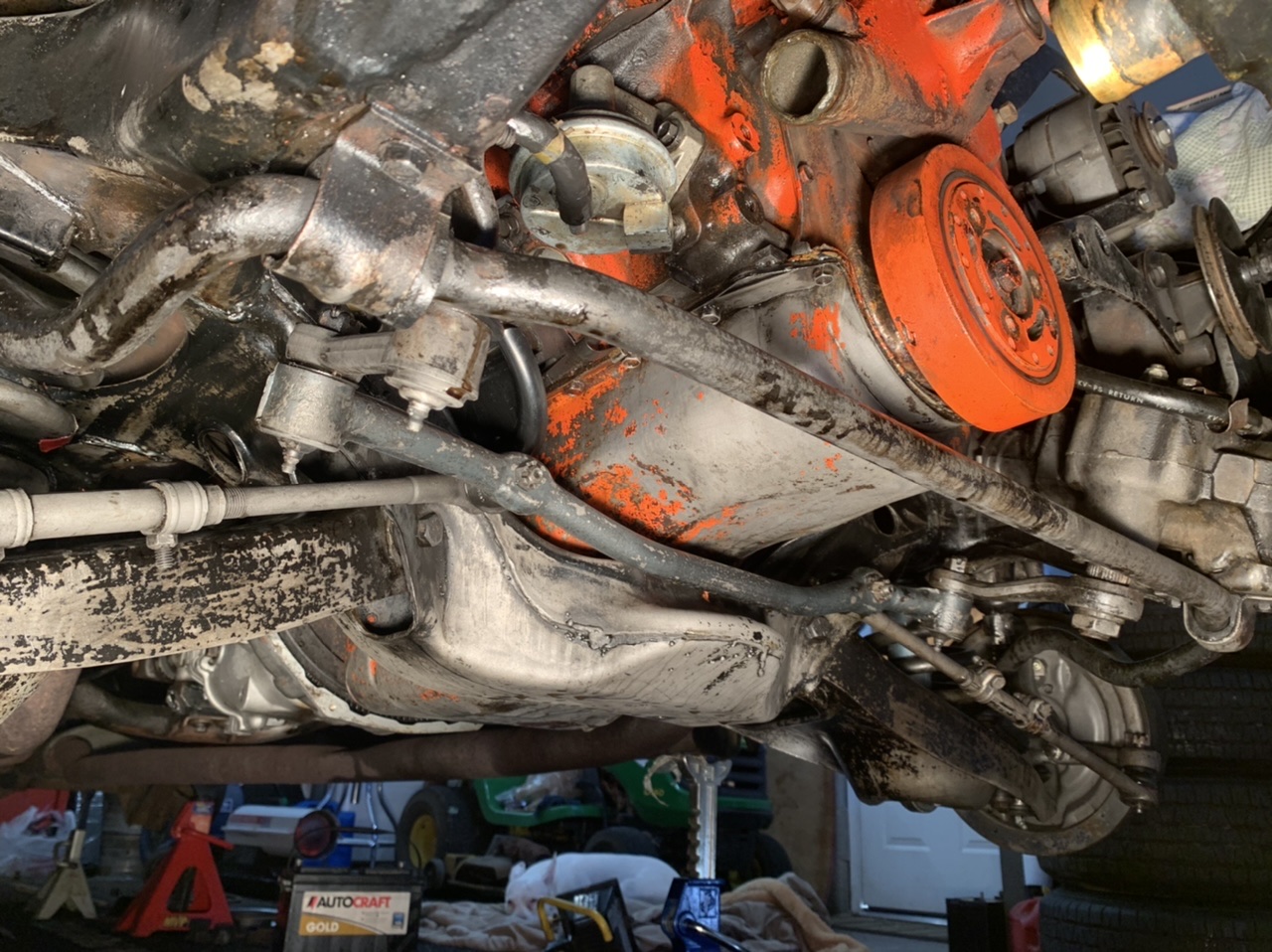

Anyone have a suggestion on what cleaner to use to remove black spray bomb paint from a firewall? Don’t want to disturb factory markings. Thanks

i used simple green on my deuce to do all the firewall/ complete front suspension/ complete front frame and it work great for me...removed spray paint overspray along with grease and dirt
generously sprayed it on and let it sit for 15-20 minutes use a soft brush and then wiped off throughly
secondary cleaning.....re-sprayed it again and wiped after 5 minutes with clean rag...and it was amazing

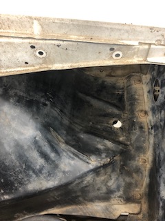

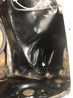

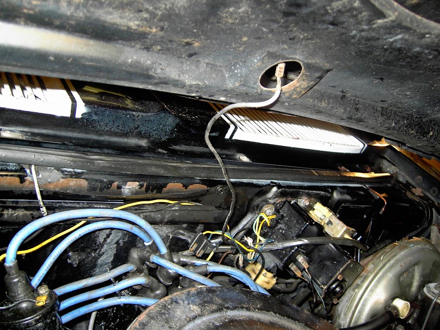

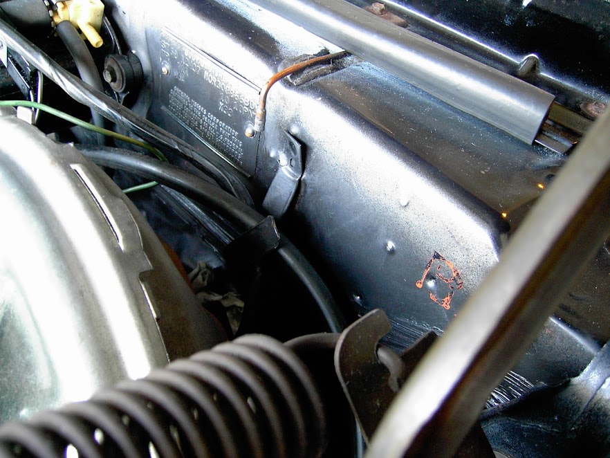

Here is before and after. Before had been scrubbed with full strength Simple green and Purple Power.

Bill, is that the wagon? Looks great! When can we see more pics of the progress?
