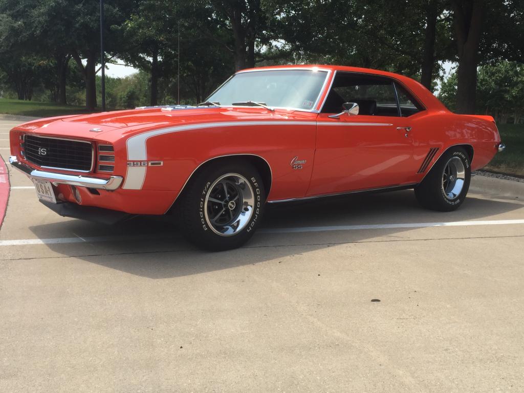

Here are some TTOs 15" x 7" in std offsets.

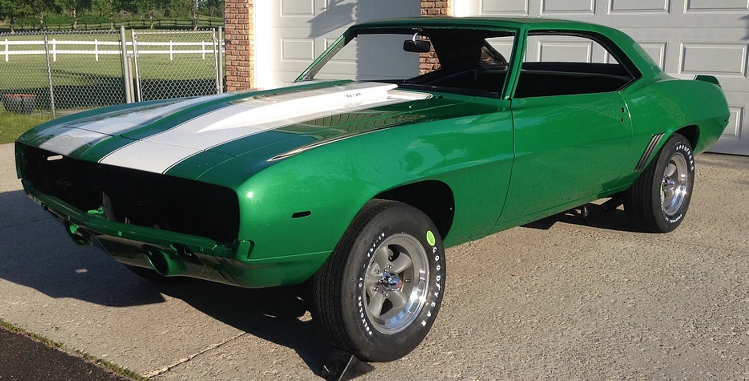

Douglass Yenko with same TTOs.

That is one good looking Rallye Green car Stefano. Is it your's? The white one, too.... Jack Douglas car? Not intending to hijack the thread, just giving credit when due.

The RG COPO is NicKey Continuation Carmaro #002. We sold it while back. The Jack Doulass Yenko is on consignment with us.
