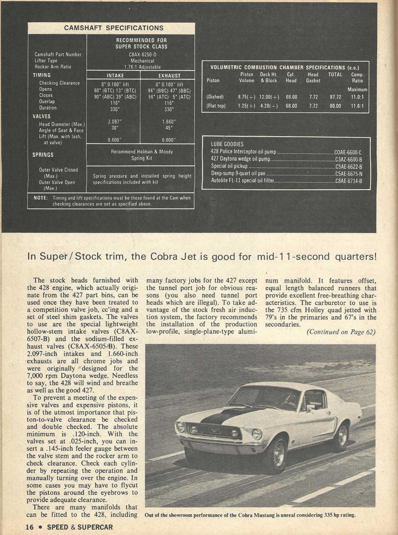

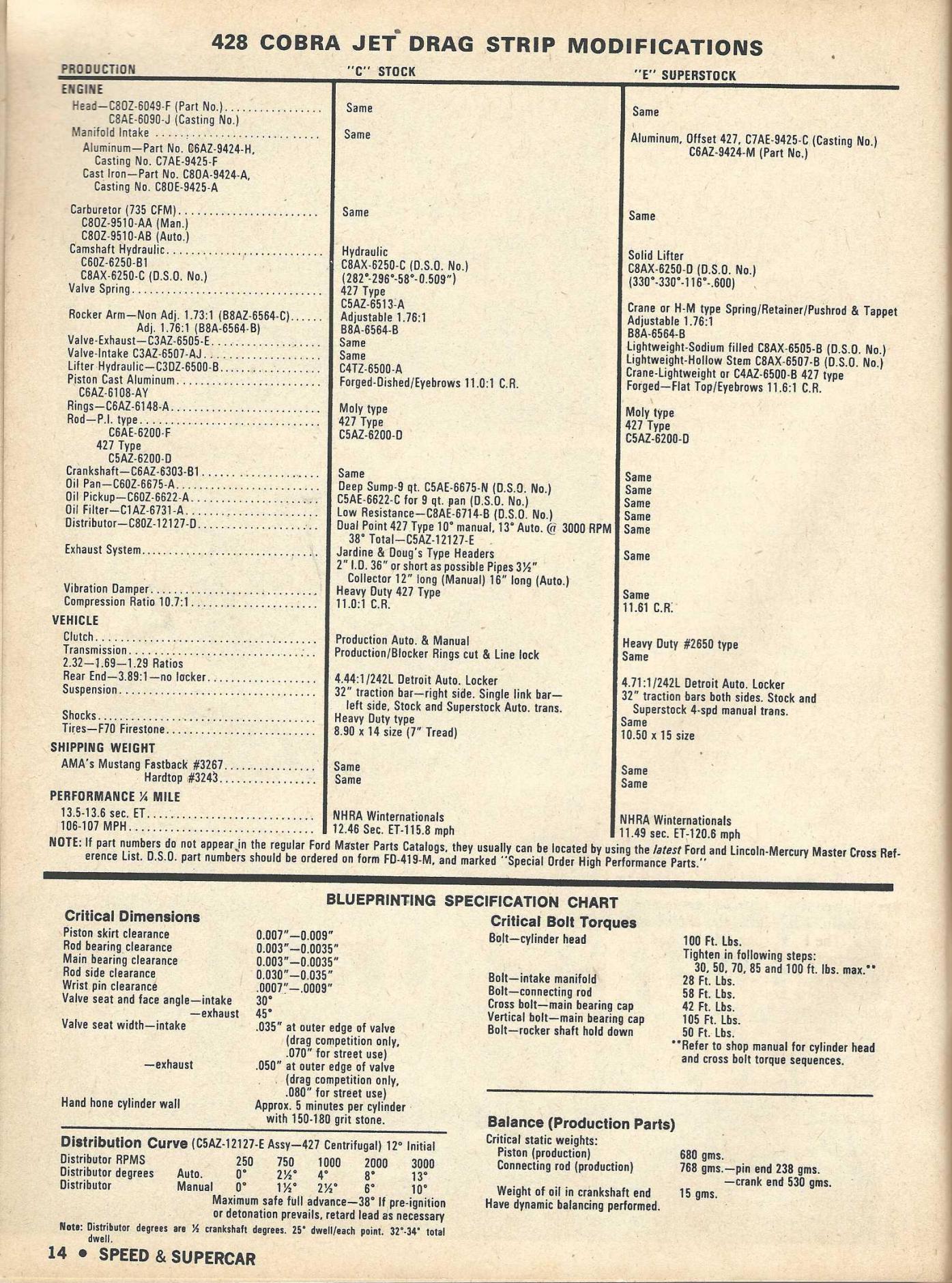

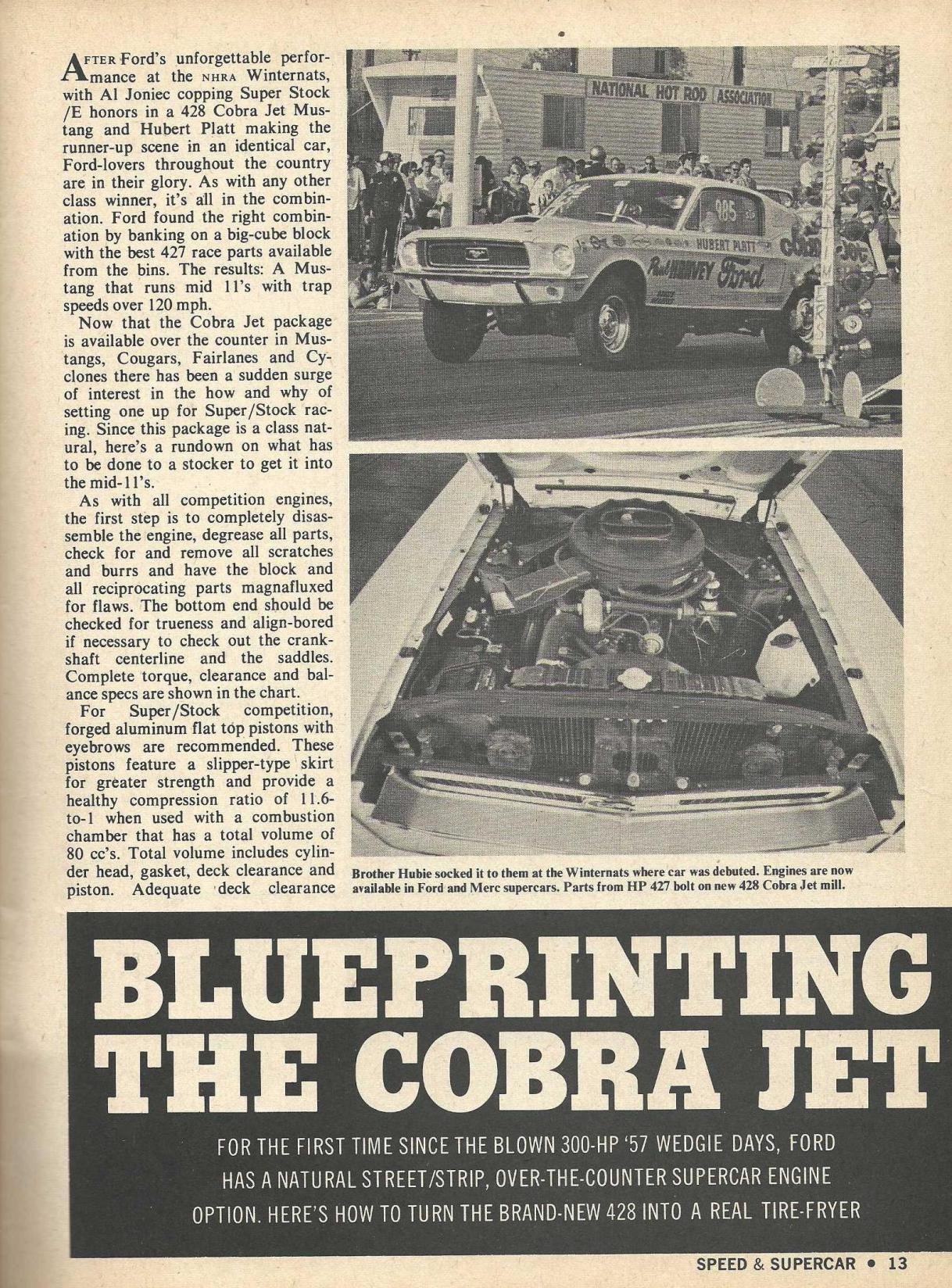

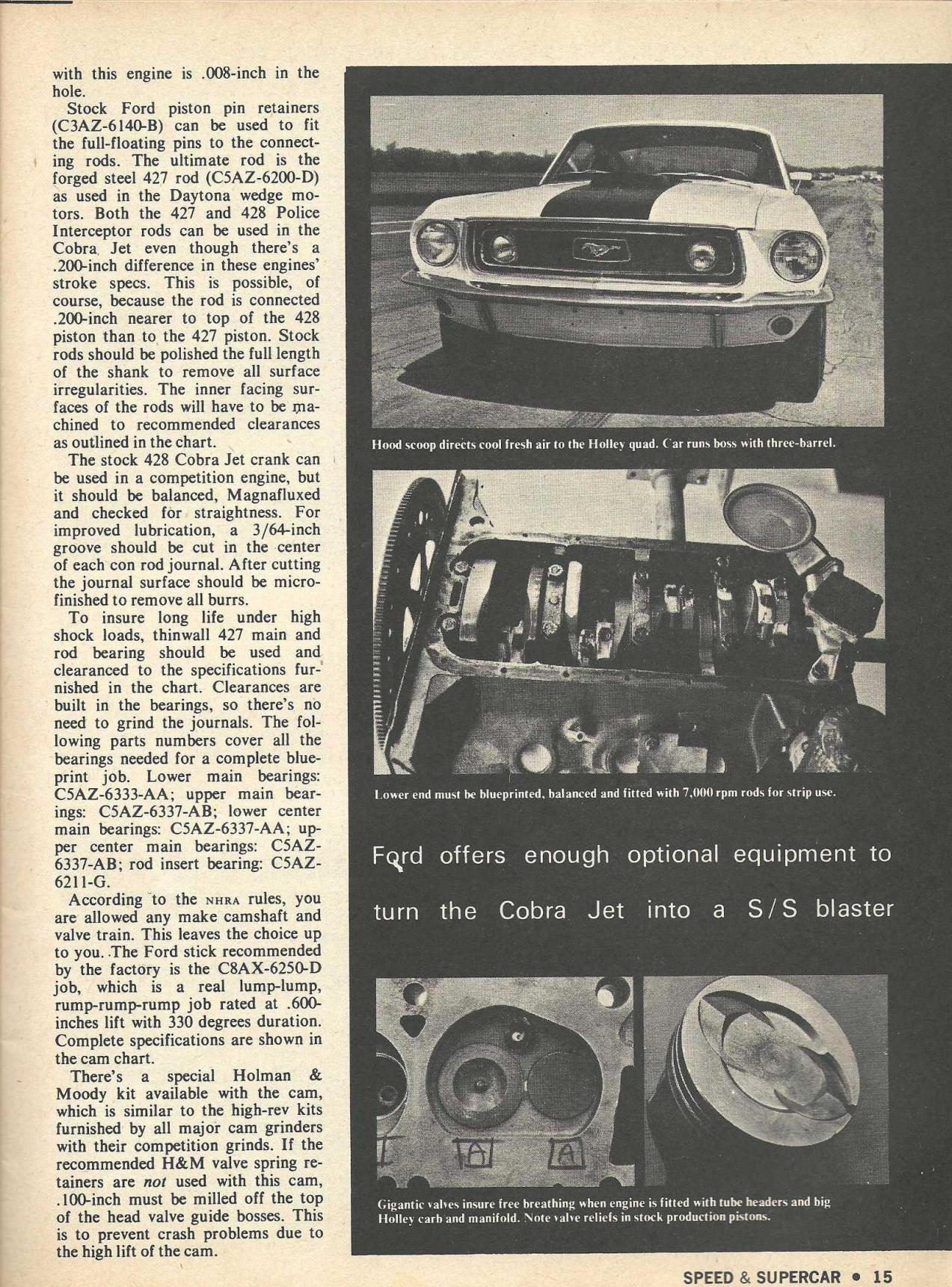

Default The 1968 428CJ Blueprinting for 11 Second Performance!!
Getting the most out of the newly introduced 428 CJ like Joniec & Platt have at 68 Winternats!...
