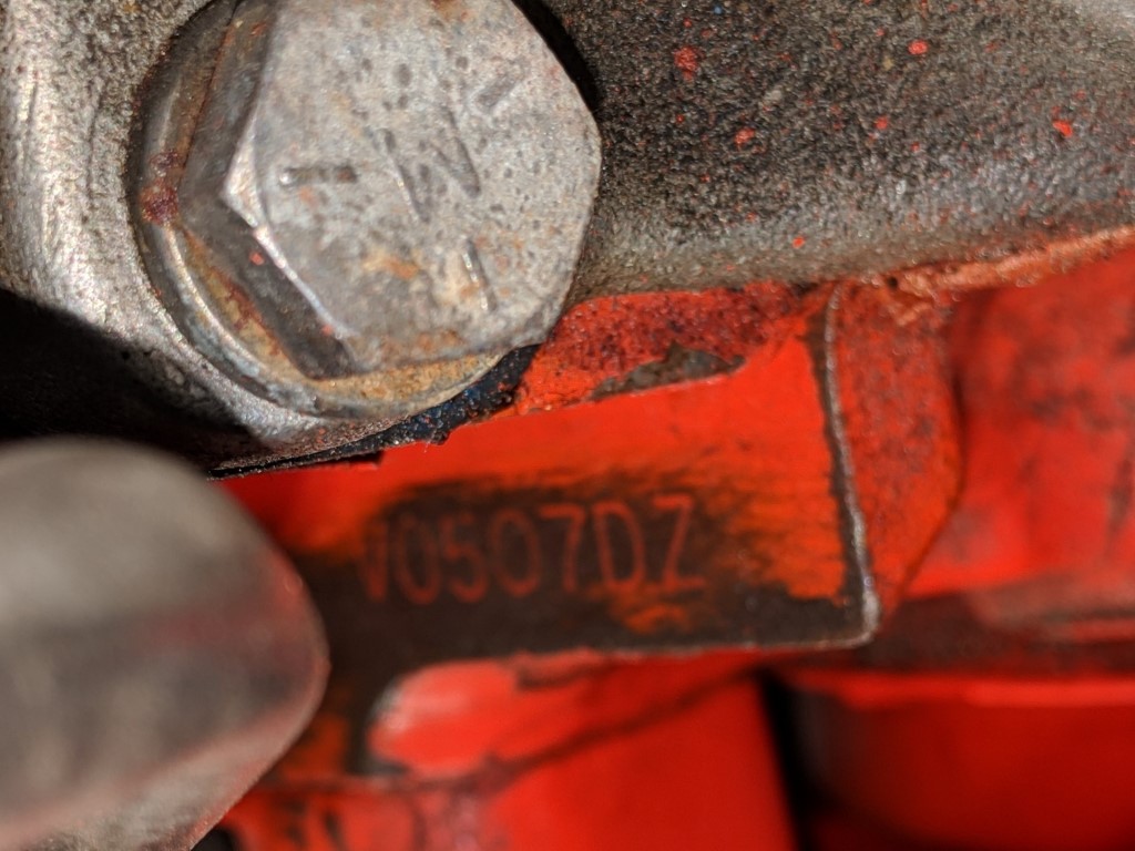

Nice car - I know we've discussed it here on the site but I can't locate the post.
Would be nice to see some pics of the engine and drivetrain stamps to back up the # claim. Odd to see a body color firewall and 'caution fan' sticker on what looks to be an otherwise stock appearing car....
Link to 1969 Z/28 auction
124379N643888
PeteLeathersac (01-29-2022)

----Standard interior with deluxe seats! I also can't imagine the car would have come with red stripes. Wow,,,Looked at the rest of the pics. Soooo much wrong! How about that red steering wheel....Bill S

Ha! I didn’t even notice the standard interior panels. Dig the comfort weave seats though.

How about where the spare is mounted!! Looks like 5 leaf springs too
Bill

Did all 69 Z’s have five leaf springs?

They should be 4. SS cars had 5.

:Maybe a Mopar guy restored it. (Paint) Really bugs me when they put the cowl seal on incorrectly.

I thought the firewall on first gen Camaros were always black.

firewall should be black
