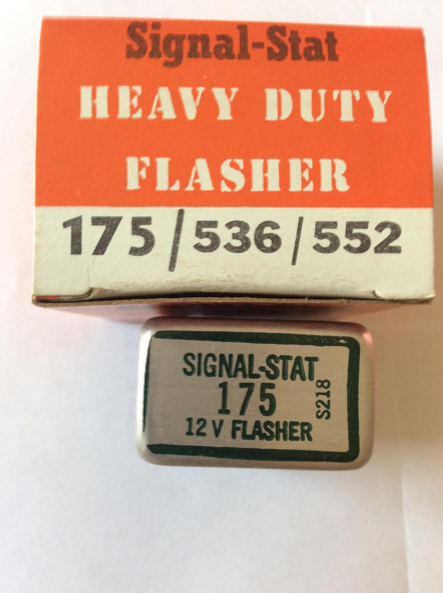

On page 88 of the 1969 Camaro Judging Manual is states that the hazard flasher Signal-Stat 175 is dated. Does anyone know how to decipher the date on the flasher I have pictured?

21st week of 1968
