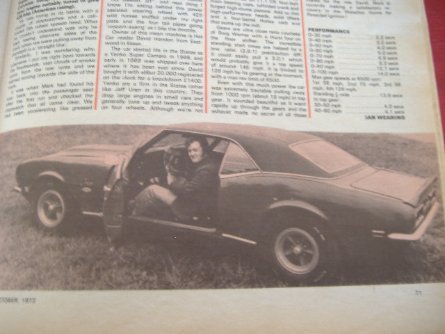

looking through my 68 file, there are 5 original 1968 Yenko Camaro photos that show the SS emblems on the fenders with the Yenko crest above the Camaro emblem.
I have one original photo showing the SS emblems removed with the Yenko crest below the Camaro emblem.

Can you post that photo?

car magazine article on YS-8027
The car was restored this way
