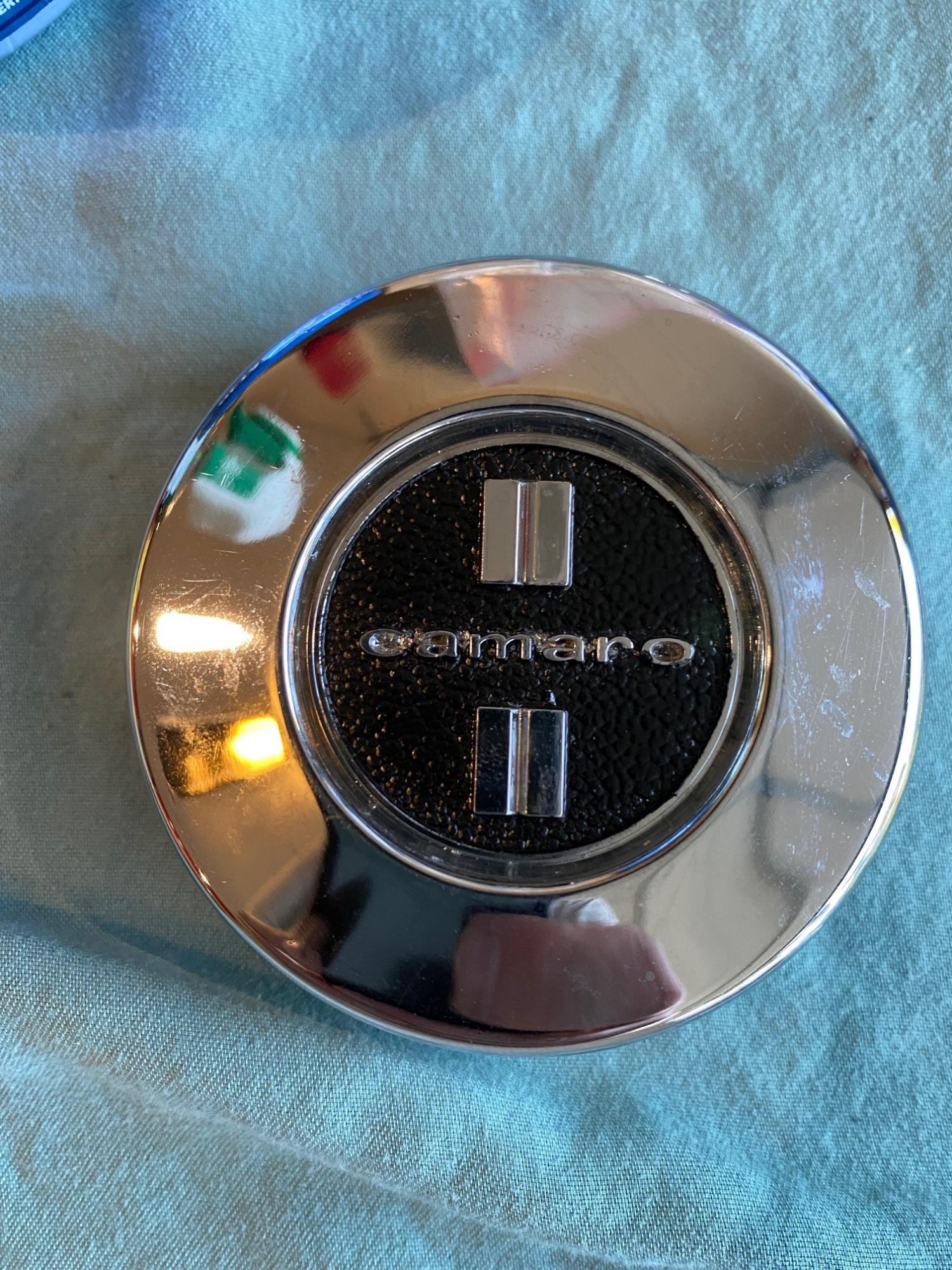

Is the correct horn cap for a standard interior 67 Camaro suppose to be a chrome finish or the dull satin finish? Pic would be nice.

Chrome. This is the horn button off my 54k mile 67 with standard interior. It's an early car. Base steering wheel.

I'd like to hear from William or Kurt, about any midyear changes to the cap, as 1967 was the introduction of the satin finish on interior pieces and the change may have taken place after the first of the year ?

Scroll down to 1967, talks about 4 different horn caps:
http://www.camaros.org/swheel.shtml#sw67
