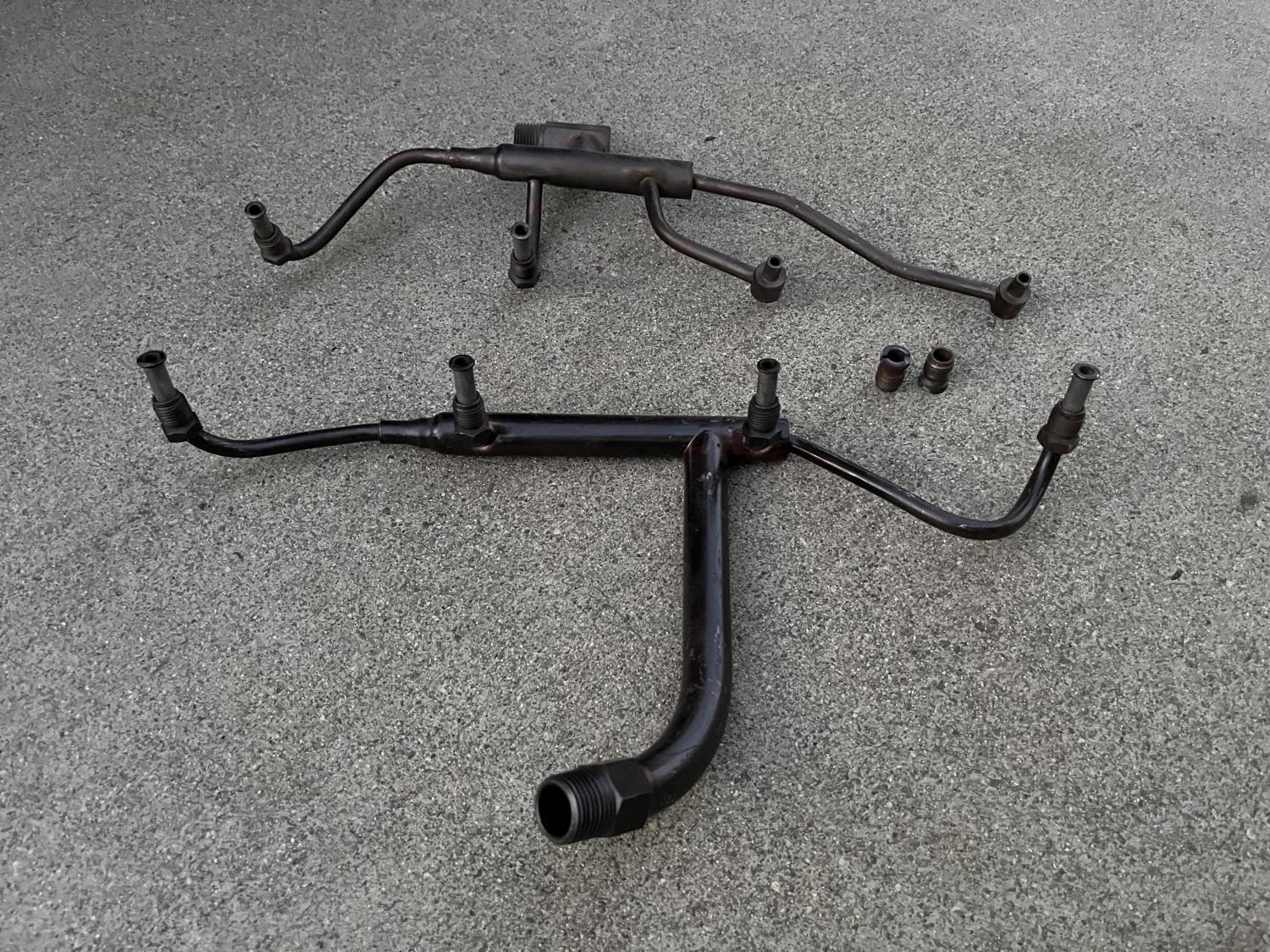

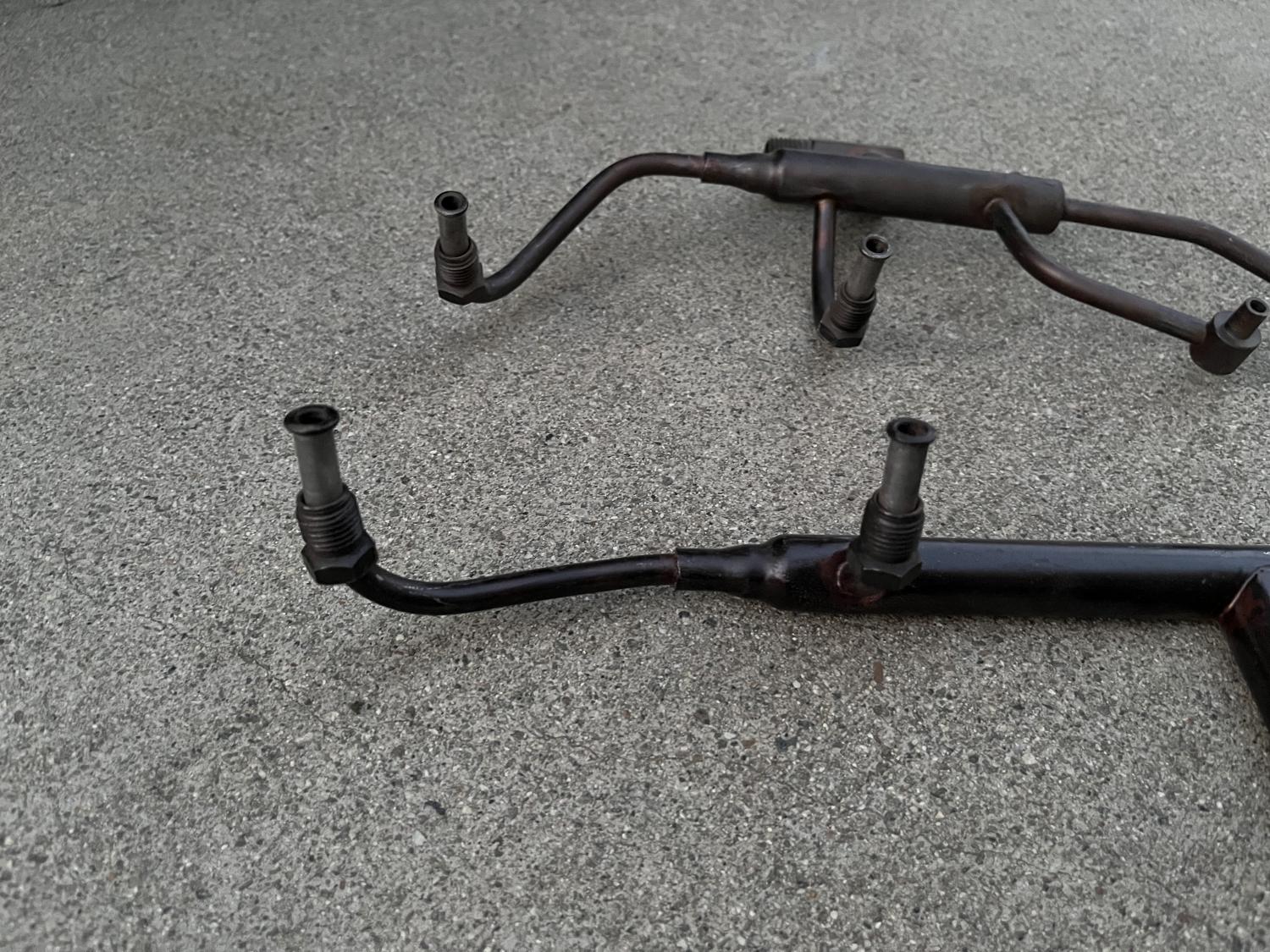

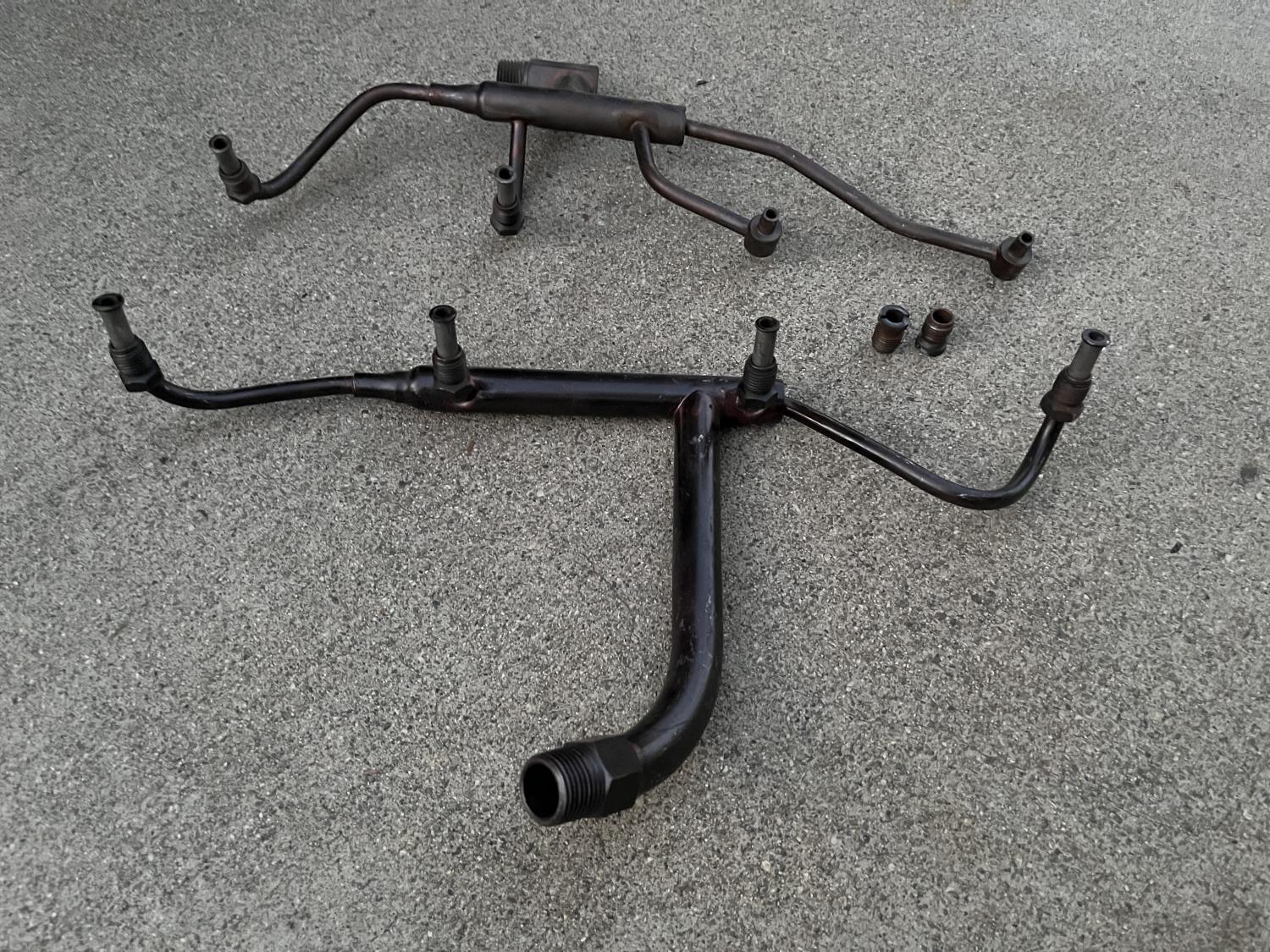

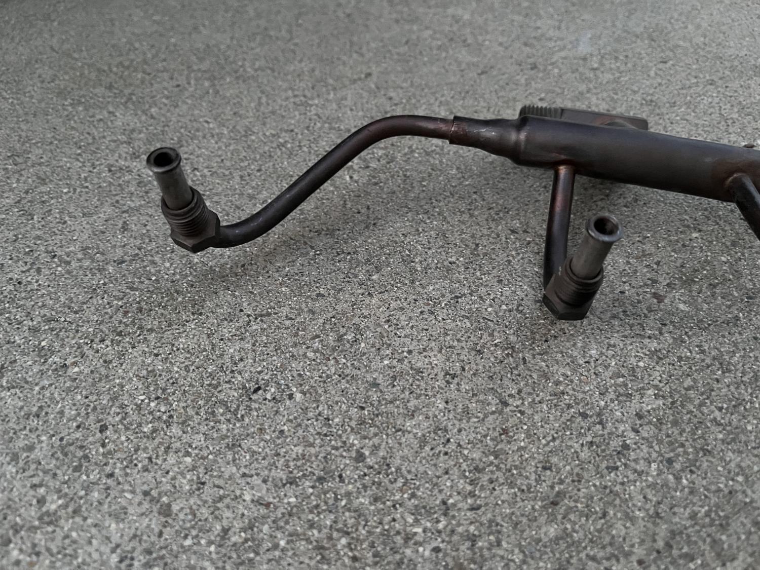

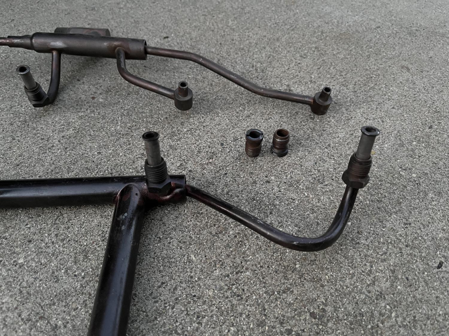

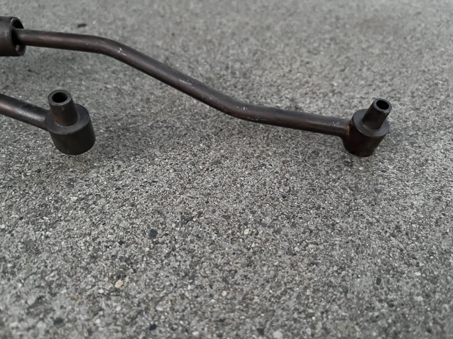

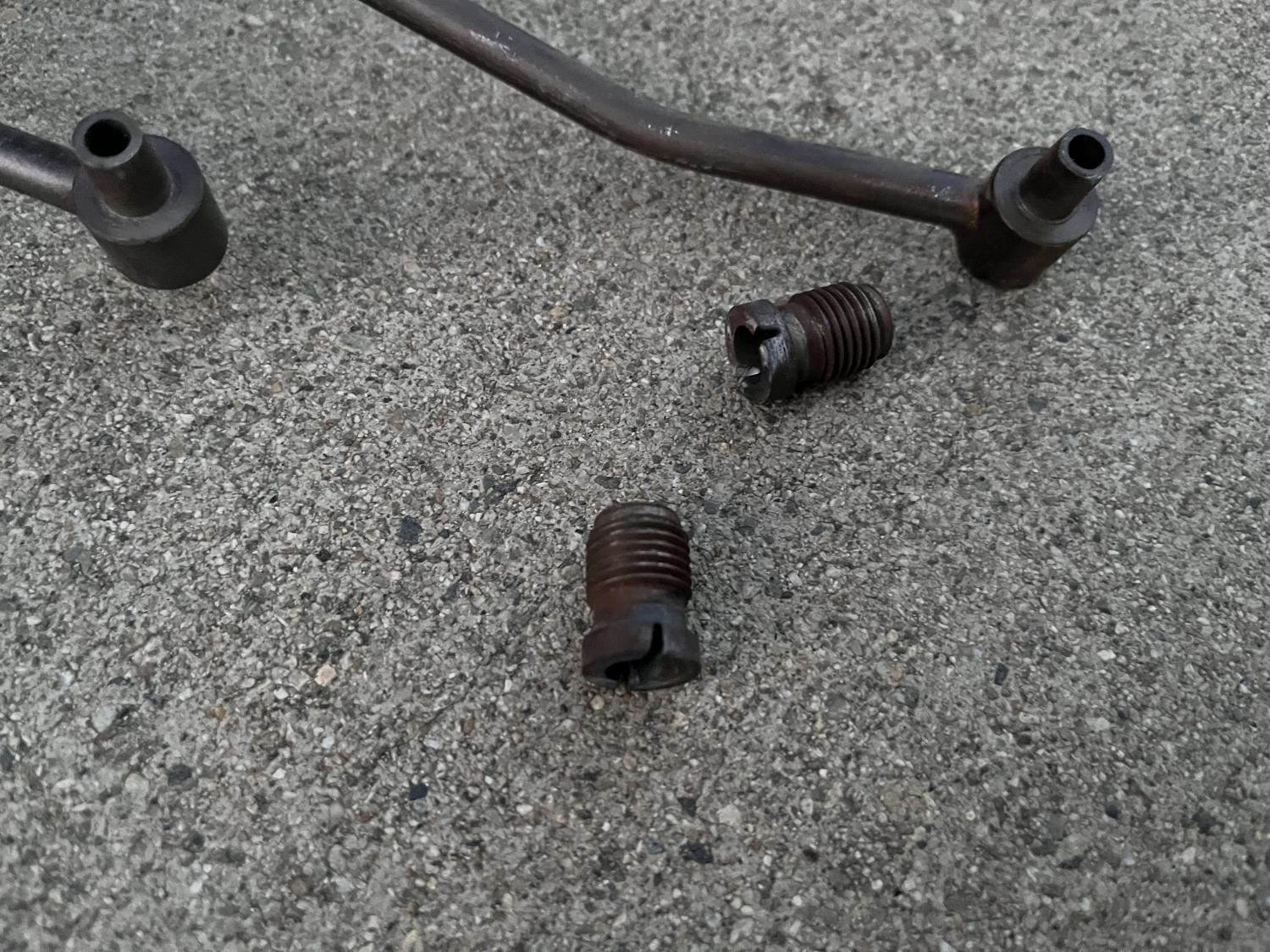

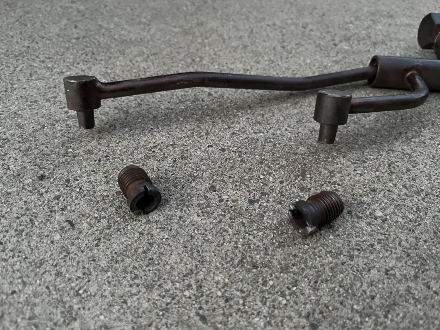

Hi Gang,
Anyone know what these are? I'm going assume OTC replacements, because of the funky, removable, screw in ends on the two ports on one side...
Anyone recognize these?
They are brown and appear unused.
Application guesses?
Thanks in advance,
Anthony

1969 Camaro 396 with A/C....Joe

Here's some more information;
LH 3940987
RH 3940936
Adapters 3921998
You can check the applications. fits some 1969 Chevelles also.
I think they're all real GM
Joe

Yep X2
Joe
LH 3940987
RH 3940936
Adapters 3921998
Joe
Thanks Joe!
Thanks Joe.
