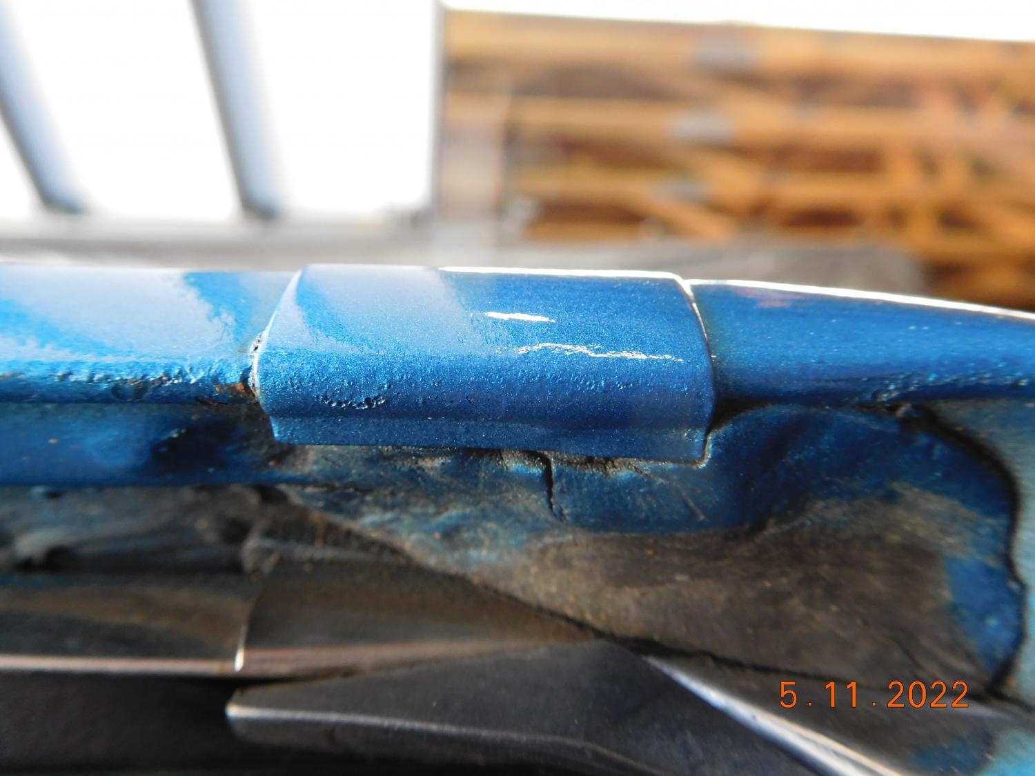

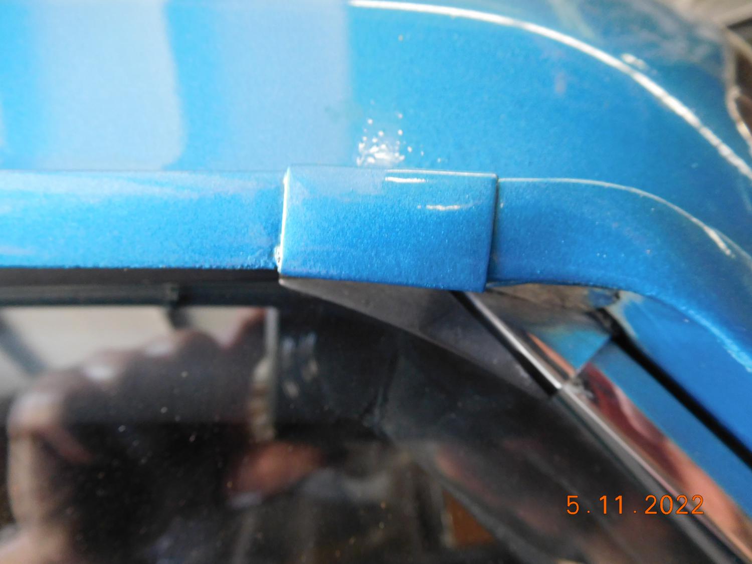

I can get a pic of mine tomorrow evening if no one else steps up.
Pretty certain they need to be installed before the sealant and the paint to look correct.
