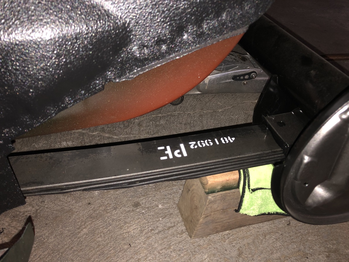

What the best product/method to duplicate the factory undercoating in the wheel wells?

As requested...this is the best photo I have in my library for the car...if you want to see any different detail, let me know.

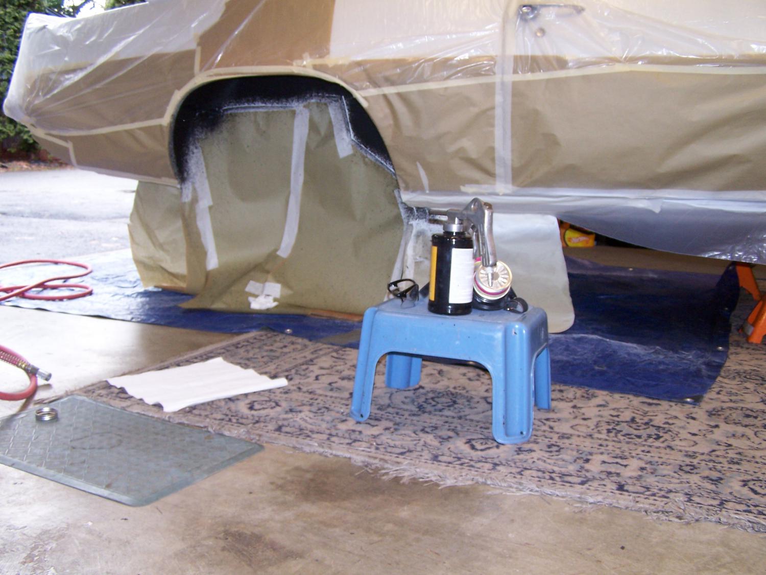

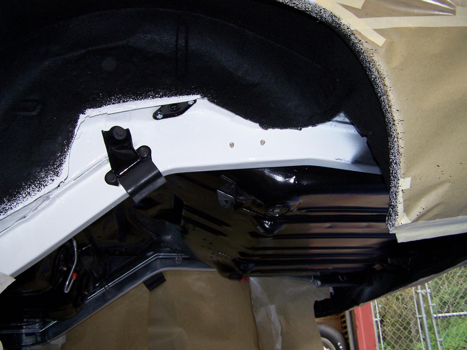

Default 3M product and applicator gun RESULTS
This was my amateur attempt on my Driver Z11 (LOS)
Using the above 3M product and "gun"
Frame on underbody Fluff.
