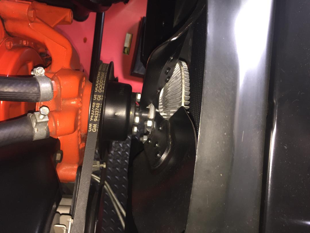

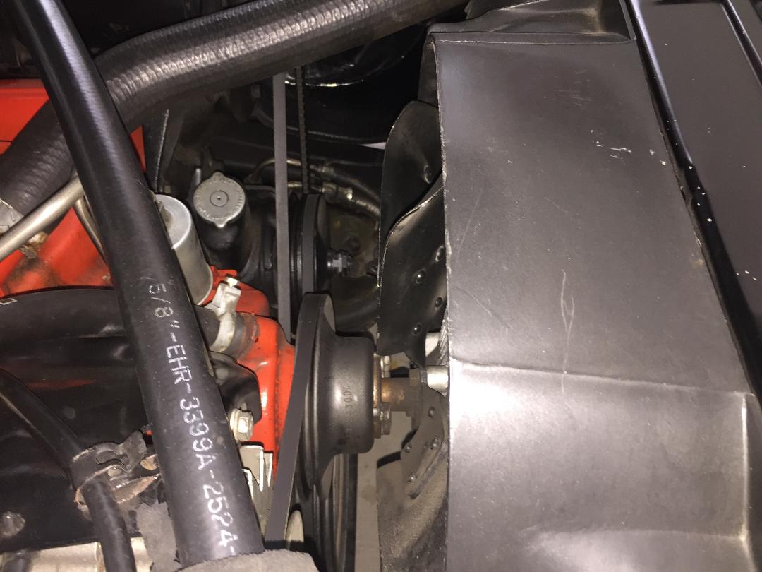

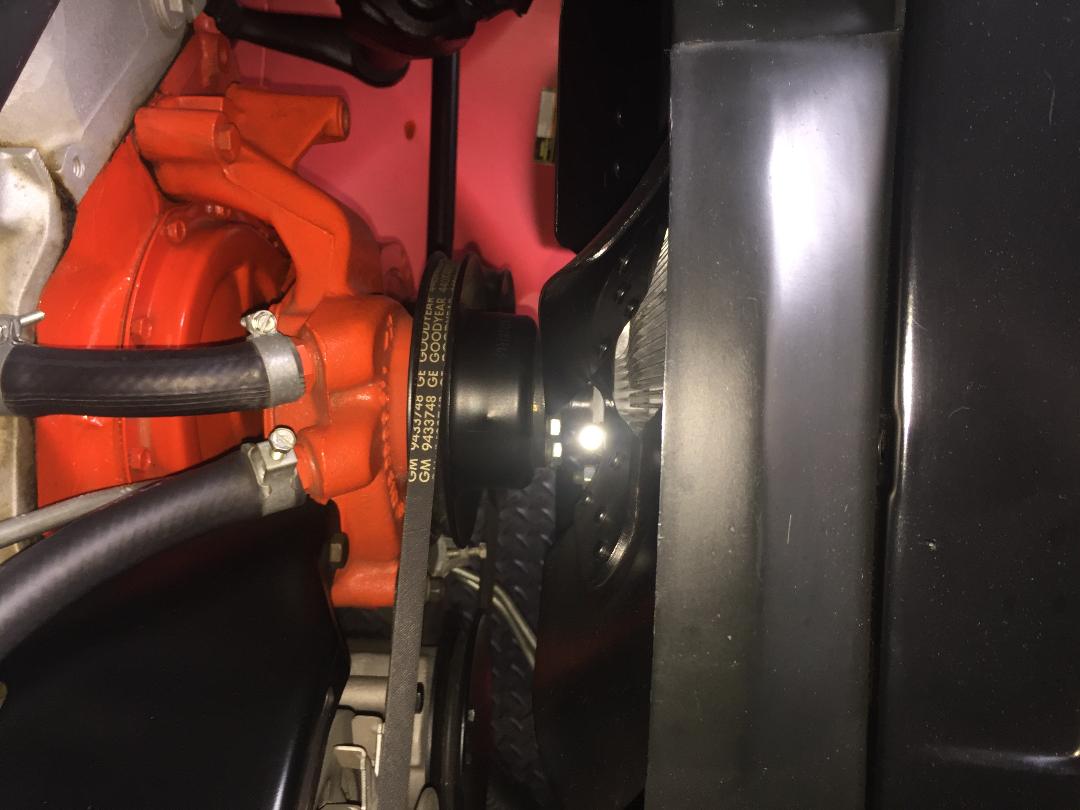

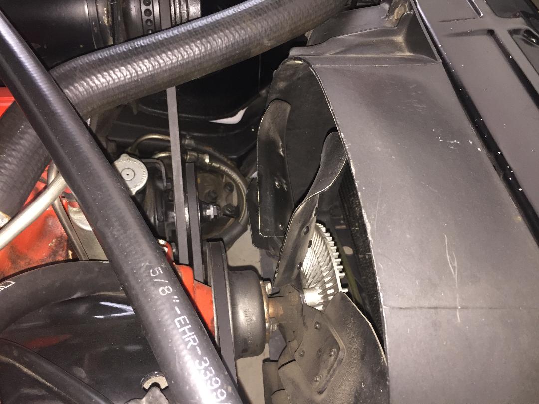

-the fan shroud doesn't look deep enough...fan blades are barely inside...the shroud measures 2.5 inches in depth...seems to me it should cover the blades more completely. He has a long water pump...with clutch fan setup.

Can someone please give me the depth of the shroud??? pretty sure this one is not correct.

Fan should be half in and and half out.

We took the shroud and fan back off...
These are the numbers from the fan...
497840. 916088 E77
the shroud has these numbers 3938165...it is not correct based on what has been posted and what I have seen online...
https://www.npdlink.com/product/shro...ro/110263/7201
If we get the correct shroud will this fan be ok..??? or do we need to buy a fan, too. If anyone has a correct factory shroud and perhaps the fan we may be interested.

The shroud is the 69 assembly line item, which is pretty rare to find. Fan blade should be the 772.

3938165 is the correct number for a 69 BB fan shroud. The later number is a replacement.
