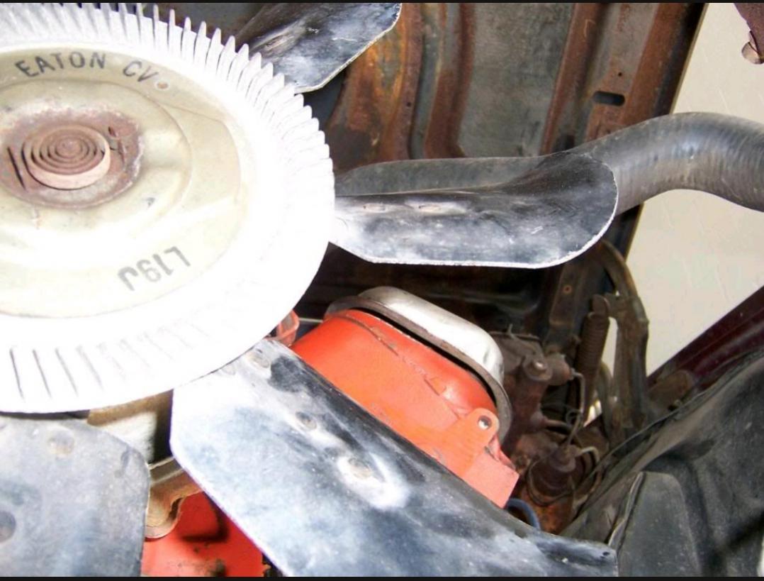

Can someone help me ID this set-up? It seems like the fan is aluminum.

Looks like a 772 fan and clutch from a 1970 vehicle. I have a similar one in my database.

Rick,
Is your fan aluminum?
Old 07-02-2022, 11:44 PM
SS427's Avatar
SS427 SS427 is offline
Location: Pleasant Plains, IL
Posts: 10,304
Thanks: 3,044
Yes

Or a late 69

The fan blades do not have the 772 part number stamped on them. What does that tell us?

http://www.camaros.org/coolingsystems.shtml#fan
