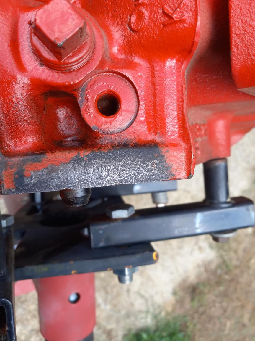

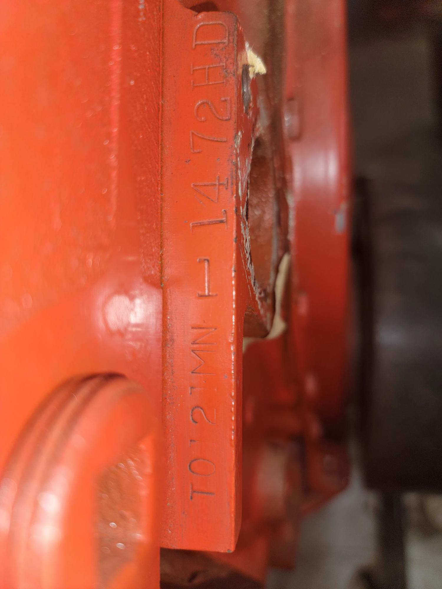

hi,i just bought a 427 suffix t0121mn vin 9n614804.the first 4 is very faint but i think its a 4.512 block a 16 9,840 heads a 3 9.has non factory stamp by suffix its a sideways 1 then 1472hd..,will get more pics when i get into it.

Can you please post a picture of the vin stamp. I believe that might be a known car in the registry.

give me a little time kinda busy and still on my truck,but i will soon as i can get it on a stand for a good pic

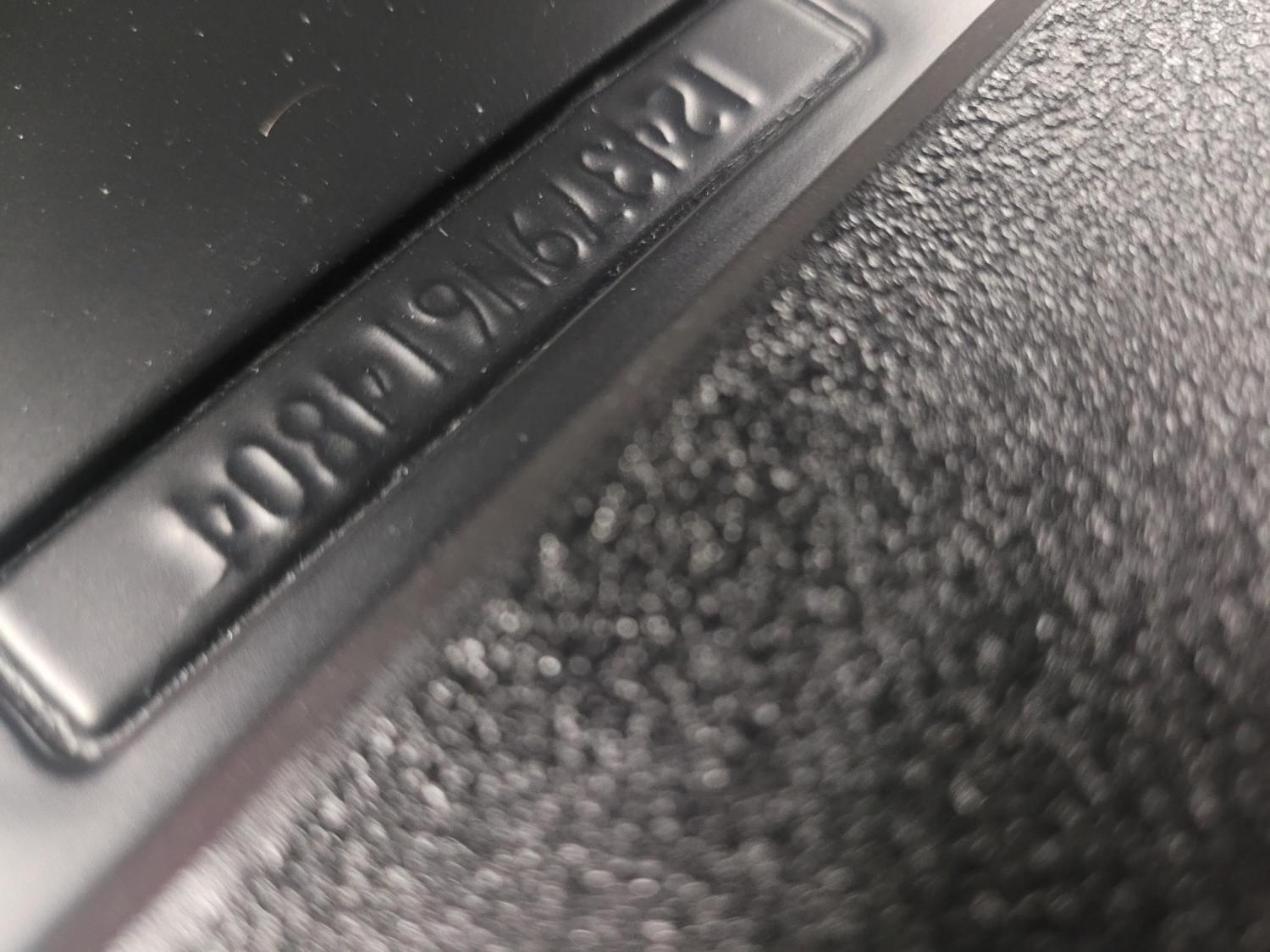

124379N614804 Sold @ Mecum 2016...
https://www.mecum.com/lots/SC0516-24...-yenko-camaro/

thanks for that link says it was built with correct date matching components but did not say it had original engine.these numbers on this look real to me.
Old 08-04-2022, 12:22 PM
Posts: 12,383
Thanks: 18,582
Thanked 5,624 Times in 2,407 Posts
VV Cooke car, Member Mrays posted pics of it from the 2016 Mecum auction in this linked thread also noted it's been to MCACN so he or others here may have more info...
https://www.yenko.net/forum/showthread.php?p=1420011
Congrats on what appears to be a great find!

For what it's worth, I have a few big block Corvette pads with the same HD rebuilder stamp and rebuild date. I've traced this builder to Kentuckey. He always stamped his initials and date of rebuild, probably for warranty reasons. All the engines I've seen this on have been Hi Performance big blocks.

Thanks for that,makes sense since the auction says the car sold new in ky.

I’m not an expert by any means but that mn stamp is definitely different than a
Couple of my original Mn blocks. The M forsure.
Did they use different stamps throughout the year for these blocks ?

Yes there were a couple M's used
