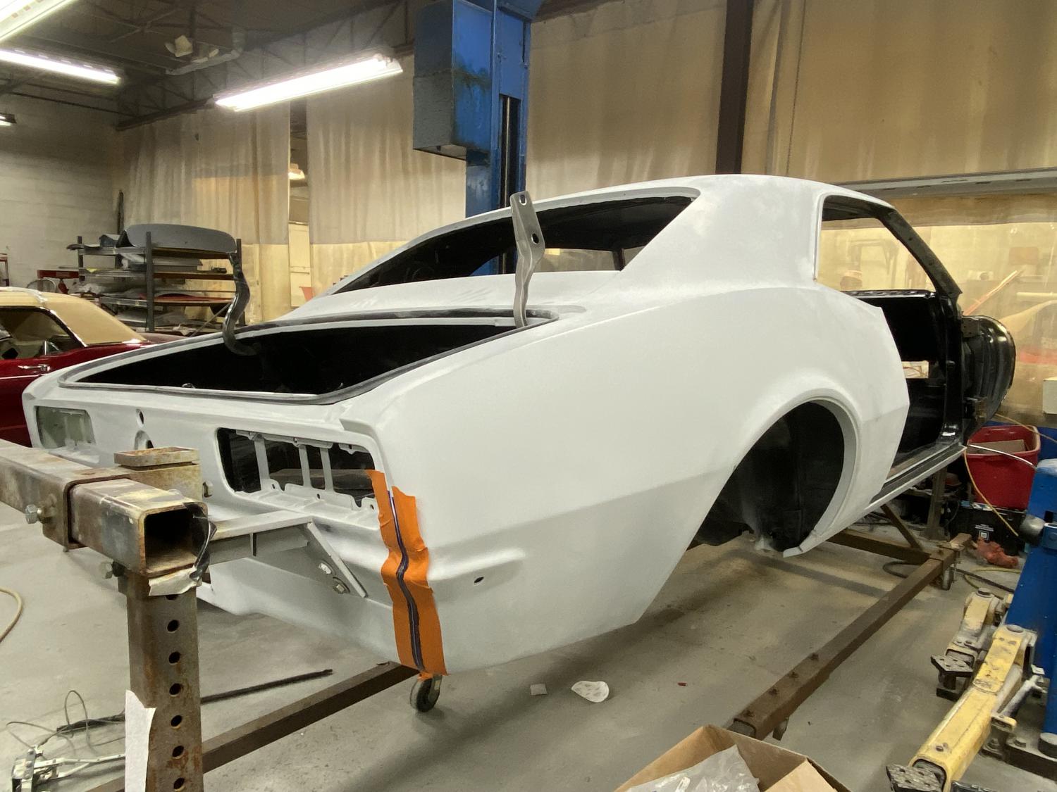

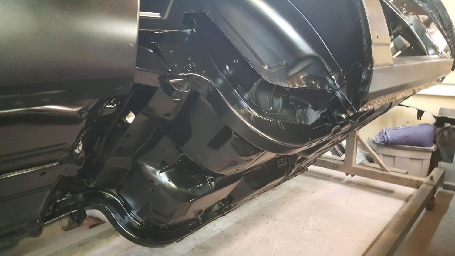

Back on the rotisserie, getting closer to paint. The painter recommended what he calls epoxy radiator black which is a pretty tough coating. I feel it’s a bit too glossy so any advice on a good product for the floor pans, subframe, wheel liners etc would be greatly appreciated. Jerry M’s book says 30% gloss for these items.
Additionally, I’m thinking gloss likely varied (as an example) between the subframe and floor pans as I assume the subframes came into the plant pre-painted. Is this a correct assumption?

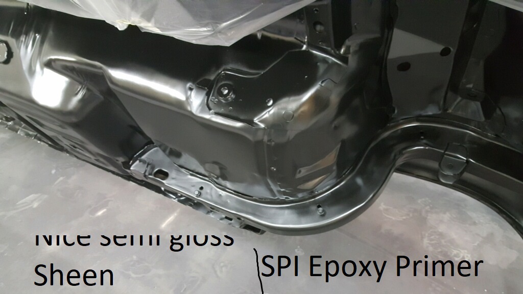

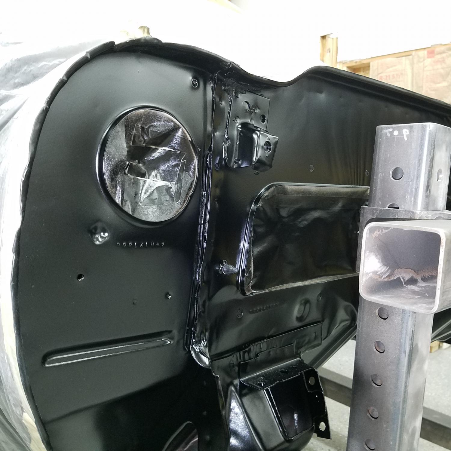

Default SPI Epoxy
Underfloor was done with SPI (Southern Polyurethane Inc) Black Epoxy
Notice the Sheen (Not Gloss by Semi Gloss)
Firewall Was Top Coated with DELFLEET Essential Single Stage Polyurethane mixed to the semi Gloss Formula

MY above SPI underfloor not only looks GOOD but is catalized 2k EPOXY......What's the Quality of YOUR suggestion ????
