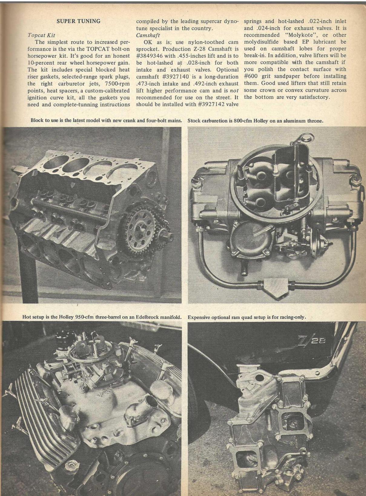

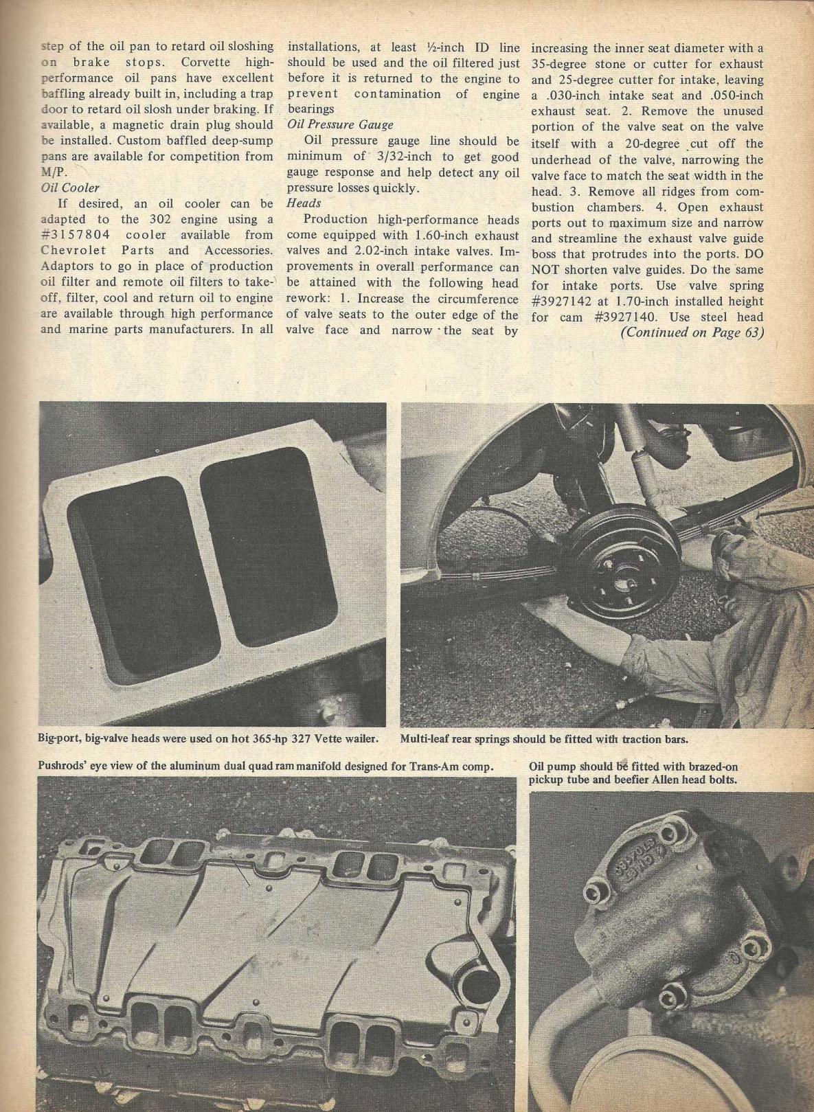

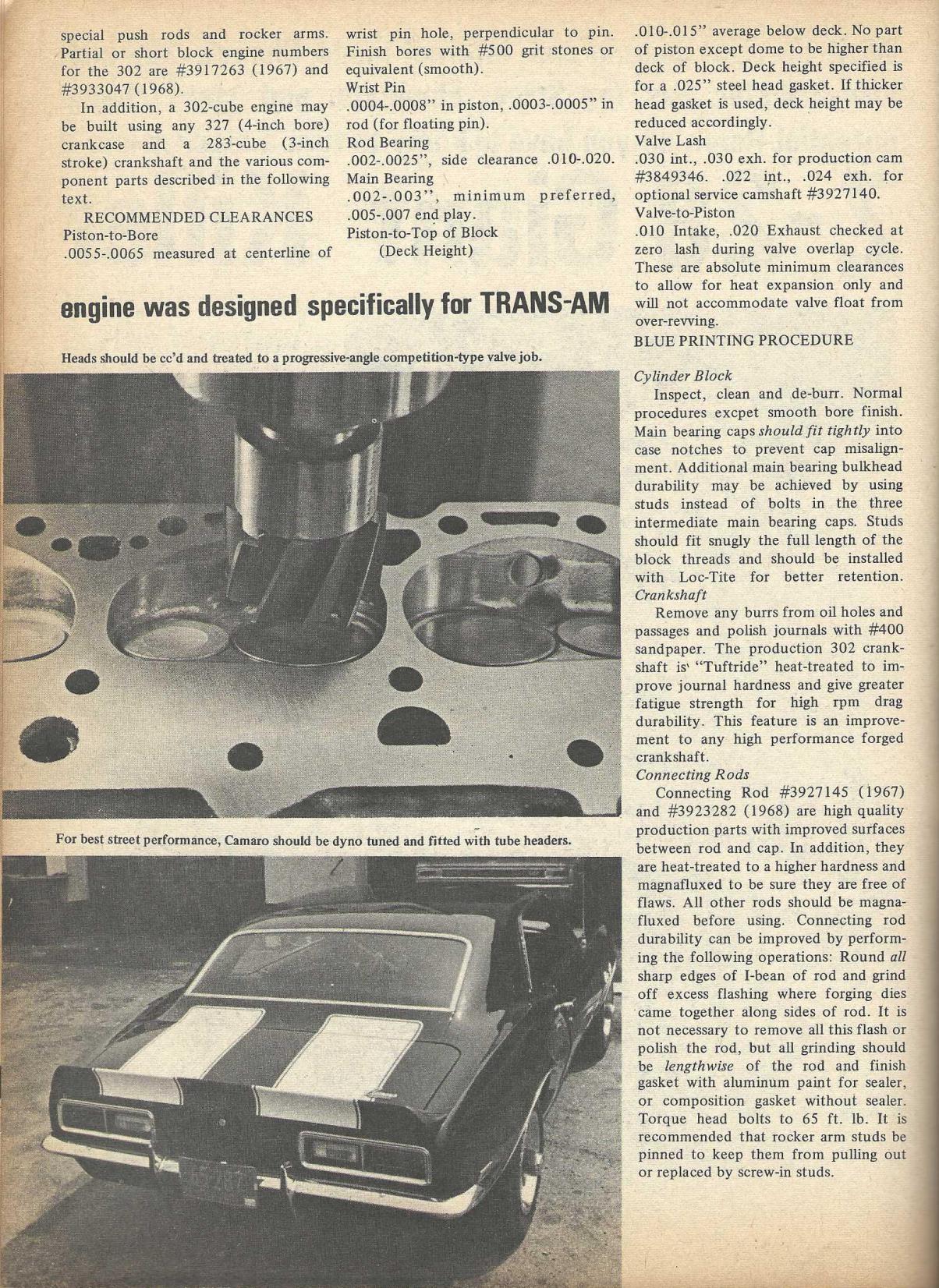

Default Build a Z/28 302 into a Giant Killer
March of 69 Build A Z/28 GIANT KILLER!
