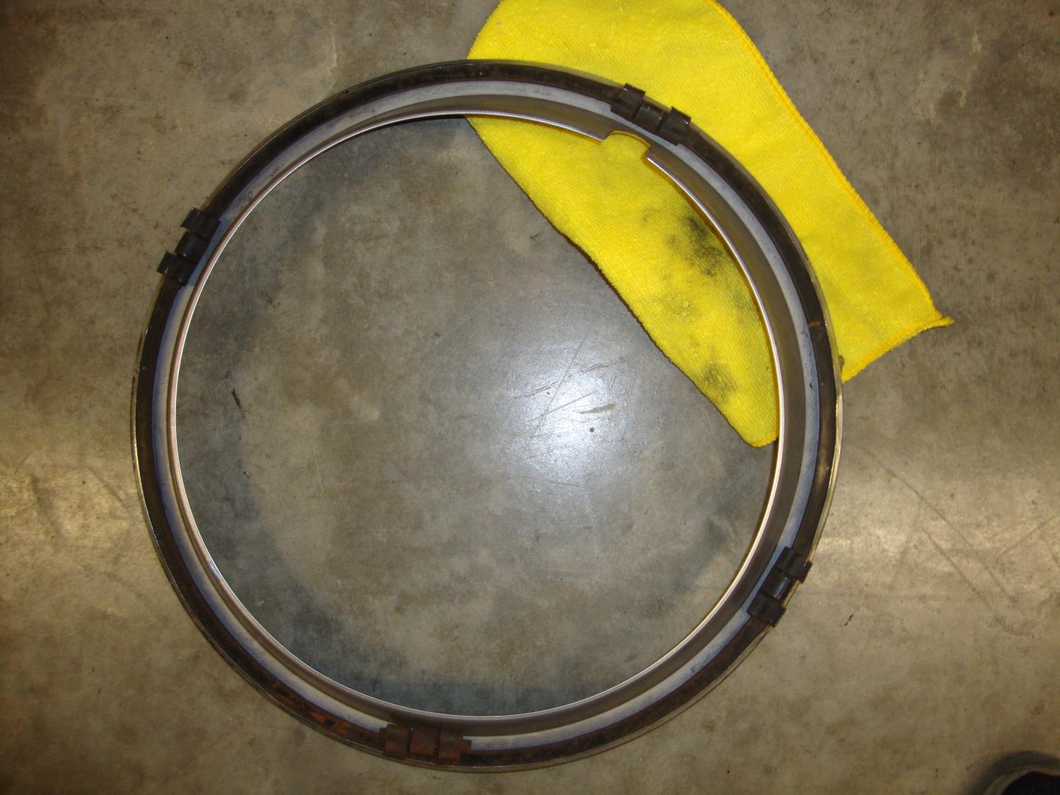

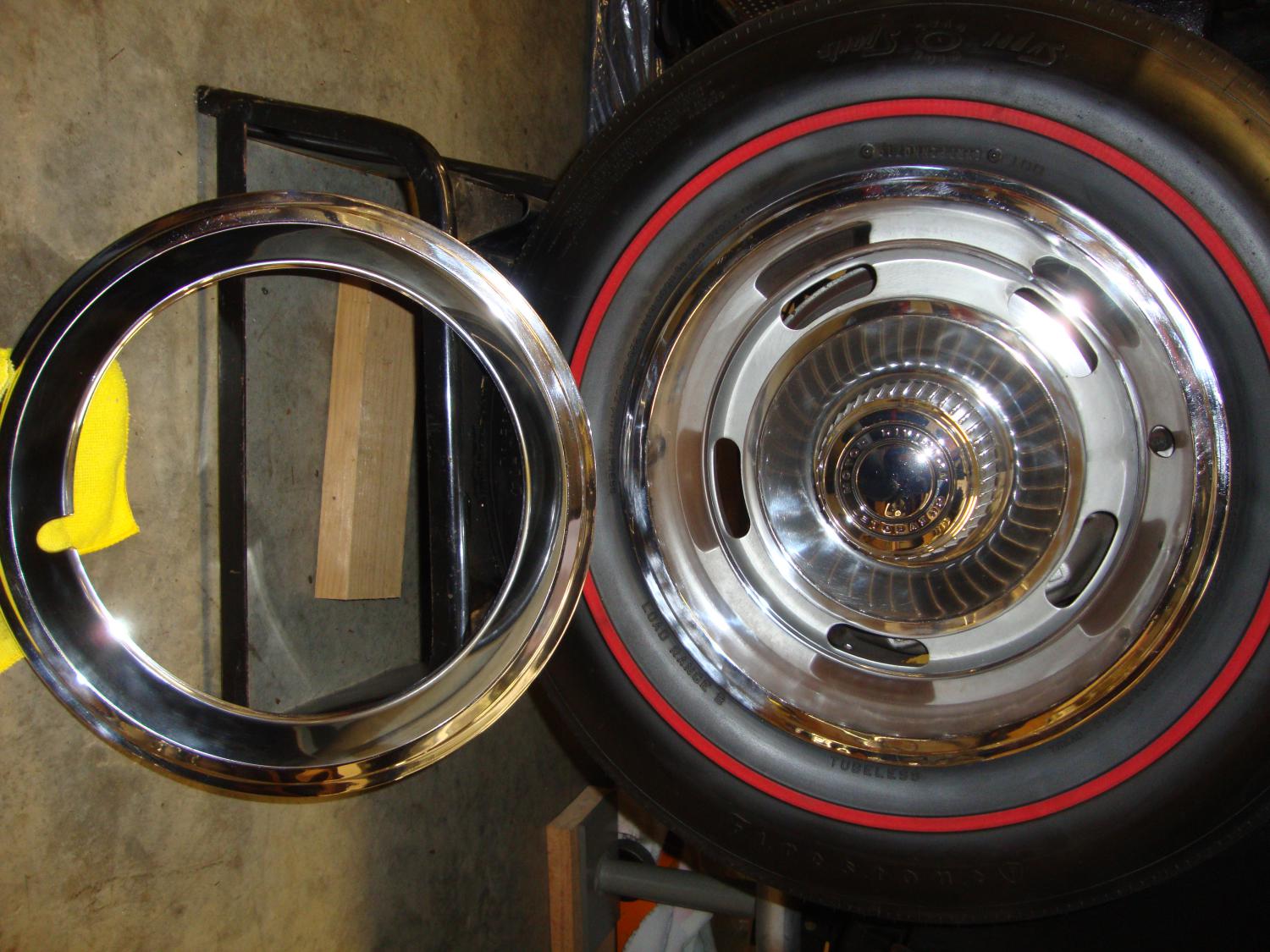

I have run a hodgepodge of rings. Finally Pulled what I believe are the correct 14x6 versions in my attic.
If 67/68 are similar ?? Not sure.
I have ran a set of 14x7 (1969) four clip rings on the red 68 for years and am transitioning to the slotted shallower rings vs- 1969 ellipse deeper rings.

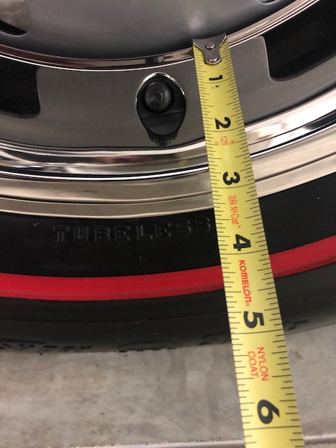

'67 DG wheels on a Chevelle used the 2 1/2" oval hole 4 clip ring whereas Camaro used a slotted ring.
