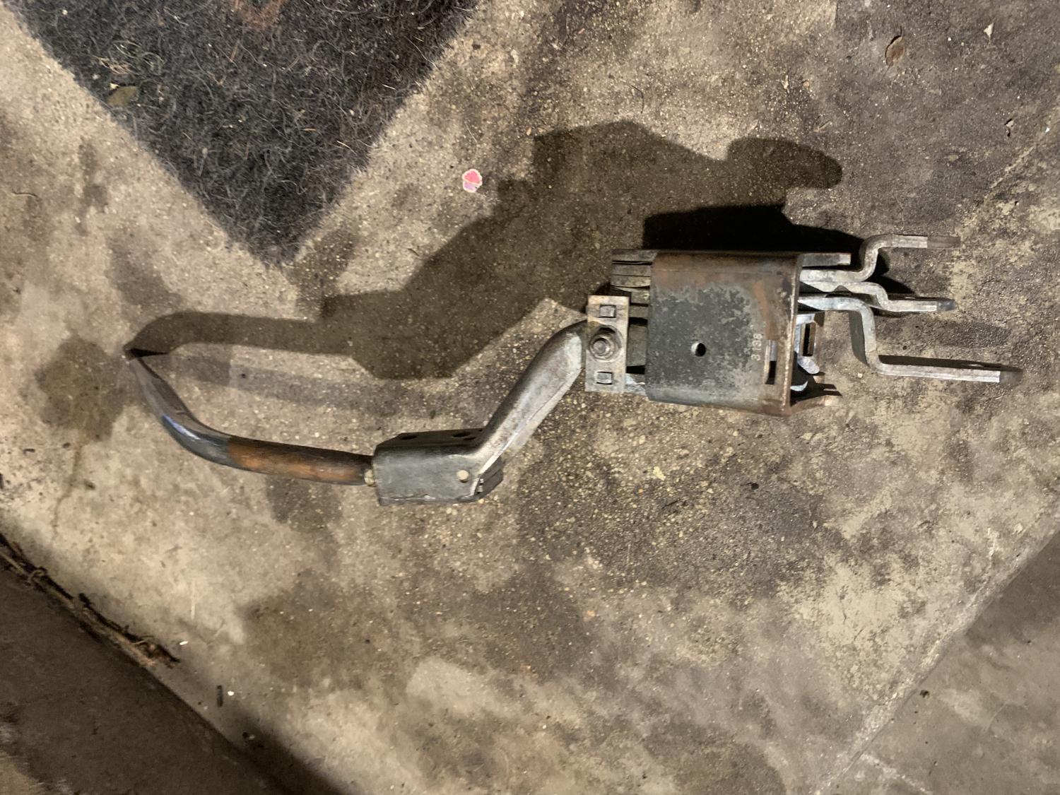

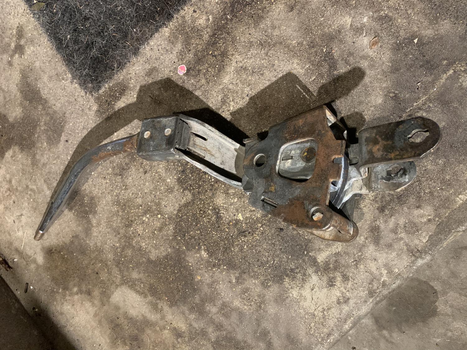

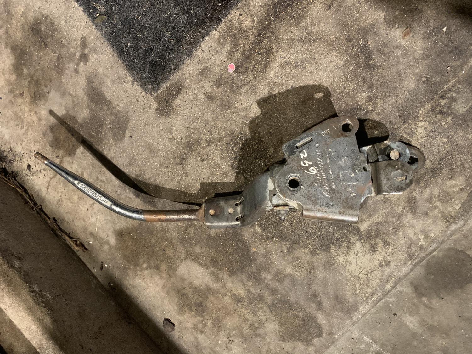

I have a 68 firebird with a super T-10. I have the shifter pictured below, 3138 body and handle out of a 69 camaro. that i would like to have mechanically rebuilt, not worried about the condition of the handle. I also need everything to install this shifter on the T-10 in my firebird brackets, hardware, levers, clips etc.
Any help is appreciated

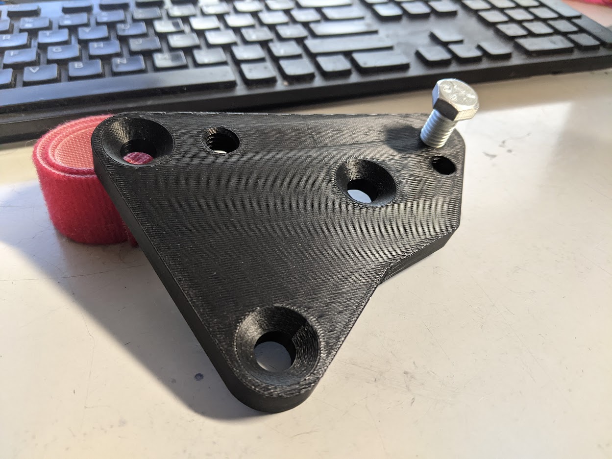

Hi Casey, it's Bill from NH. Met you a few years back picking up that 427.
Are you looking for correct linkage for the 69 Camaro shifter- or just anything that will work?
Be advised- if you want to bolt that shifter to a ST-10, you'll have a bit of trouble with the adaptor plate. The 69 used a different bolt pattern on the trans tail shaft housing- so you can't just use the stock Muncie shifter plate.
I just modeled and 3D-Printed this Plate yesterday- it is exactly what you need to use the stock 69 Shifter with a 70-up Muncie or ST-10.
I just put a 1970 M22 in my 69 Z28, and used the original shifter.
The 70+ shift levers are different too- but they swap right onto the linkage rods no problem.

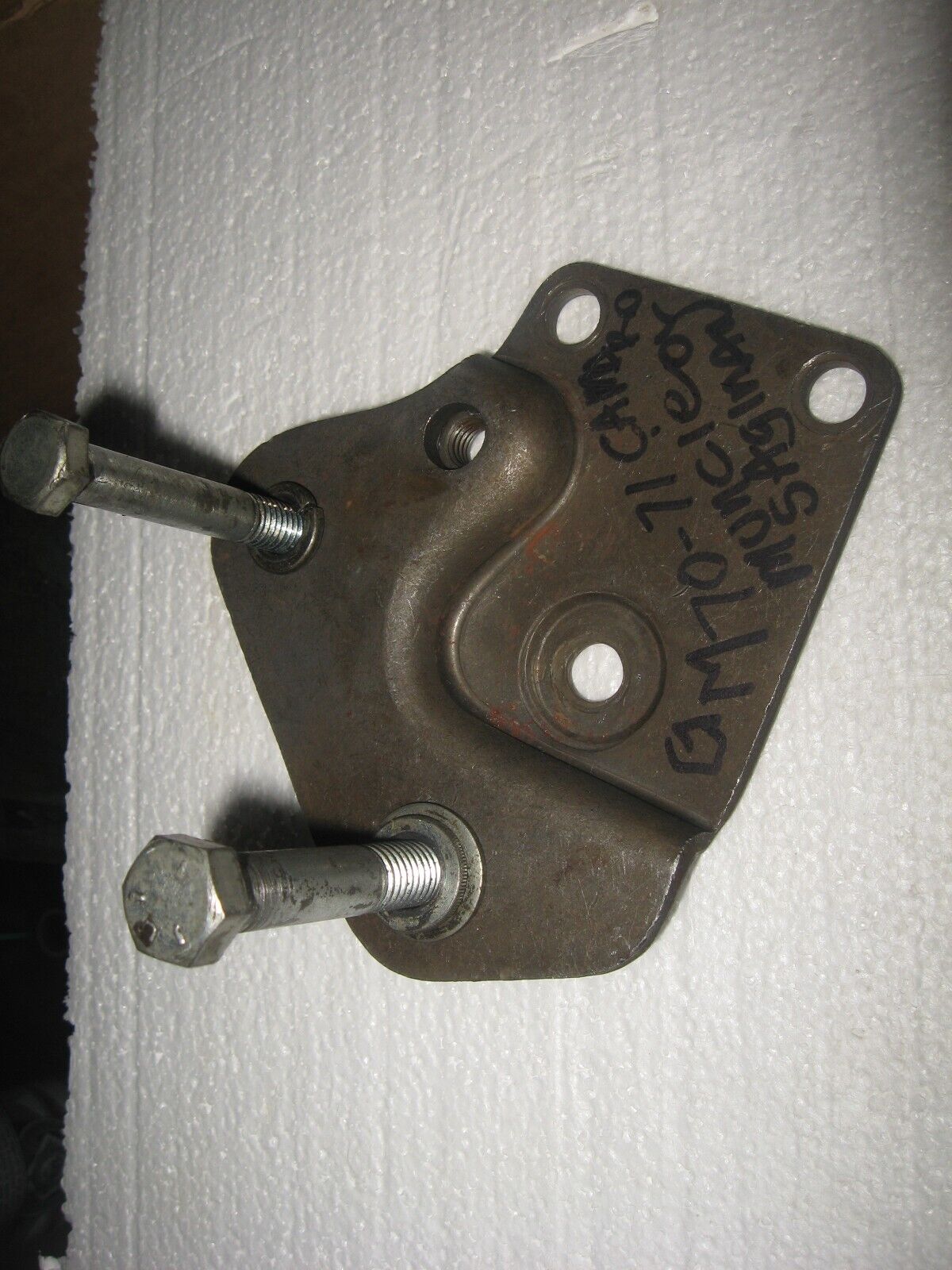

I put a ST-10 in my 65 GTO- but I was able to use a 71-81 Camaro Adaptor Plate.
Worked perfect- even with the factory console.
That plate won't work with the 69 Camaro factory console though
