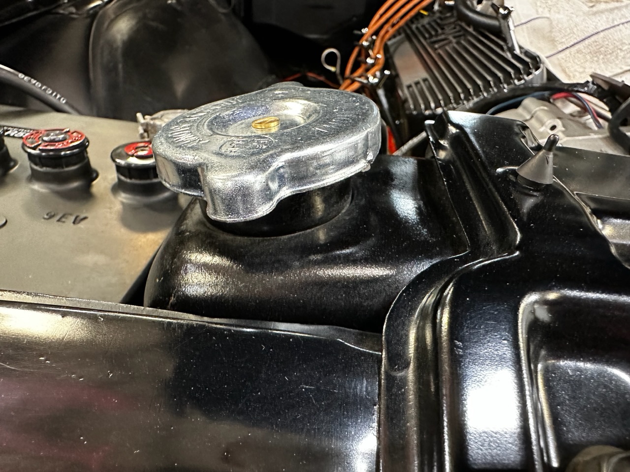

My 69 SS has a rad with an angled filler neck, does anyone know if they were angled or straight from the factory?
I'm trying to decide if I should have mine re-cored or buy a reproduction rad?
Where's a good place to buy a reproduction?
Thx

They were flat in 1969.

You may want to take some pics of your rad and post them on here. The only rad I'm aware of with a curved neck was in '69 Camaro COPO cars. It may have been transplanted into your Chevelle at some point. It may be of interest to others on here.

I believe he is referring to the filler (cap) area not the top hose.

Here’s mine.
