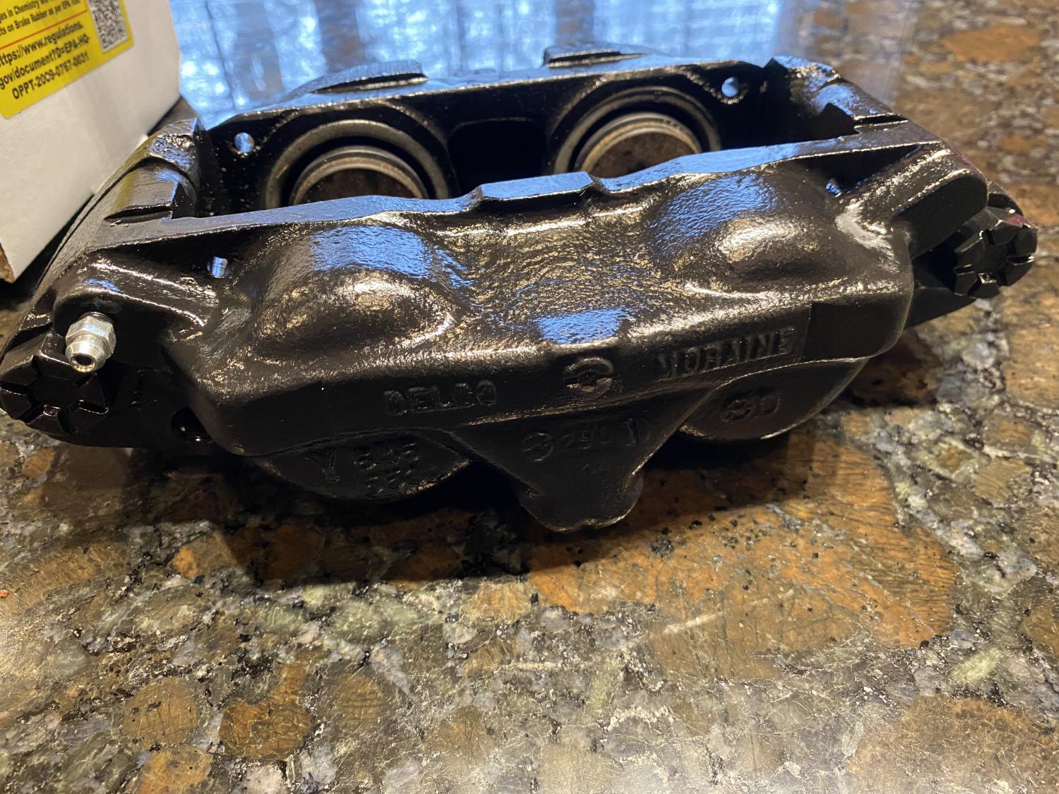

Who rebuilds/restores brake calipers? I need the 4 piston calipers for my Beaumont rebuilt. I'm having a hard time just finding rebuild kits for the 4 piston ones.

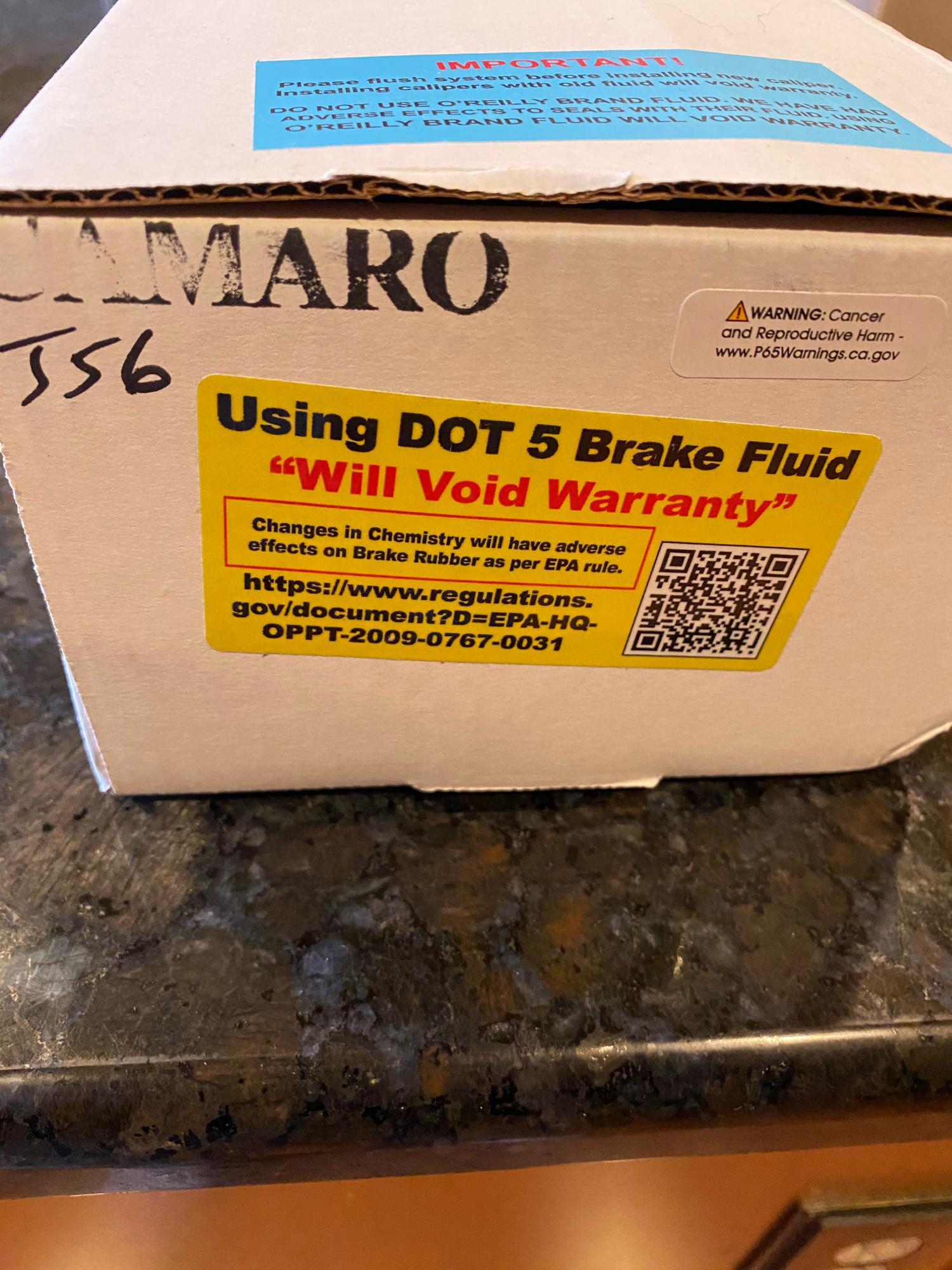

Chemistry is not my strong suit, I have been told by Muskegon that the old formula DOT 5 has not been available for several years and that current DOT 5 is not compatible with the brake parts in our old cars.
Lonestar, and I believe White Post and Karps warranty is voided with DOT 5.
If this is incorrect, please set me straight! - Bill W
