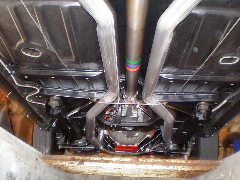

i am looking for the correct color for the markings on the drive shaft on a 70 duce[350 motor].are there any markings on either u-joint? any markings on the rear end??

Three stripes are on the driveshaft, approx 12 inches back from the front yoke. Yellow - Green - Yellow, the colors are approx 1/2 inch wide, 3/4 inch apart. I have not seen any other colors on the drive shaft.

Marlin;I will get the imforamation for you,thanks. this is a 4-speed car,350 motor.i found the markings on the front spindals when i took the car apart,and put them back.

JD, I had inspection marks on my 70 396/350 Nova driveshaft and rear end yoke. Mine is a 4 speed car. My driveshaft marks were also a different color.

The John Deere colors would actually be ok! The pic I have was actually an accident. I just held the camera on the floor to get an under car shot of the brake cables and exhaust (14k mile deuce) and when I got the pictures developed I saw the driveshaft stripes.
