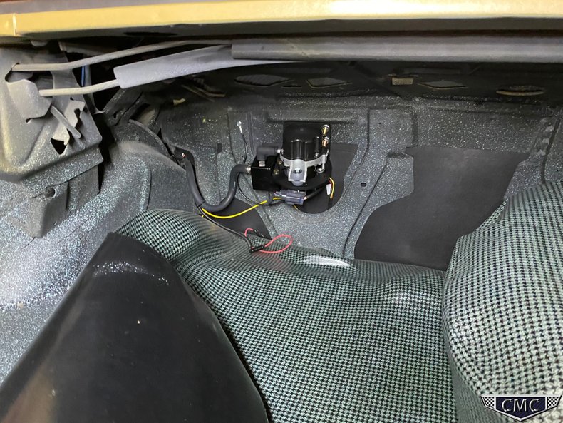

Sharp car with what appears to be the original dealer invoice, but the quality of the pics is garbage. Anyone familiar with this car? Asking price $85k.

Pad is a restamp.

Lipstick and makeup. But it's still a...

Those exhaust manifolds..

The front headlight doors and grill fitment are awful. Probably a cobbled together car.
