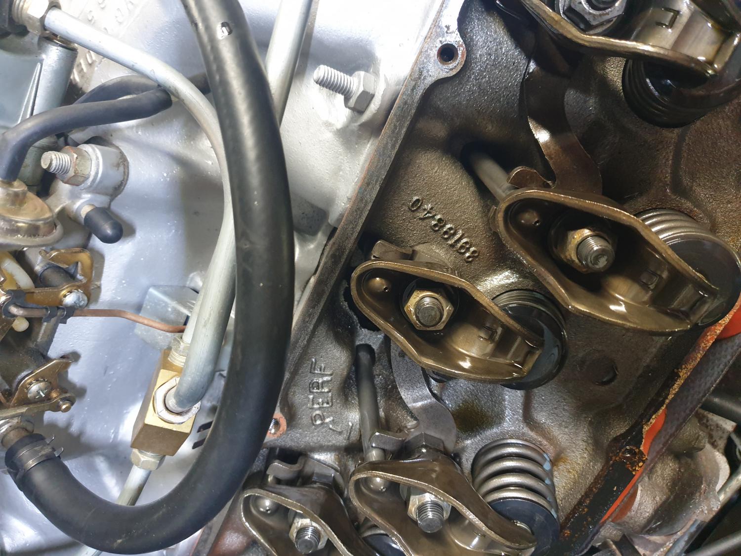

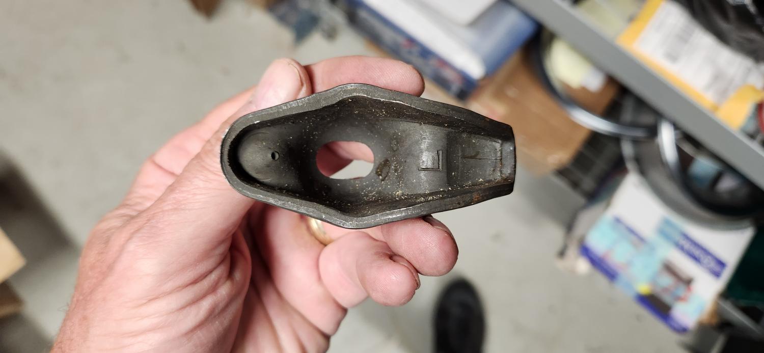

Was adjusting lash and was curious to see if anyone can ID the manufacture of these rockers. On a 69 L78 Camaro motor. I did google search and found some with same "C" made by Elgin but the C was facing away from the rocker stud.
06A X66 711 57 57 L78 M22 BU

All the original L78 motors I have seen are stamped with a L for long slot. There may have been other manufacturers

These have the same markings as yours. I have the same set on my L78.
CRANE CAMS 13800-16 ROCKER ARMS - CH. 396-454 V8 STAMPED 1.7 LONG SET/16
CRANE BBC Steel Rocker Arms1.70 Ratio- 7/16 Stud.

Thanks Dave! Mystery solved!!

I wonder if my motor has a Crane cam too? Do or did they make a solid L78 spec cam? I definitely have a solid cam as I can see the C clips in the lifter tops when I look down through the heads where casting voids are.

Why do the C-clips show they are solid lifters?

Is this not correct?

No. If there was no clip at all it would be solid. With any kind of clip it could be either solid or hydraulic.
