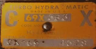

What would be the standard , eg transmission for a period correct application.
Would a tranny built 14m0nths ago be to long of a time frame. What's the vibe regarding period correct versus matching numbers ?
Eg installing a tranny Turbo 400 from a 400 hp 1969 corvette for a yenko nova LT 1 ?

If you are asking specifically about the TH400 application for the Deuce the correct unit is coded CW. This is the same unit used in 1970 L78 applications and the 1970 Z28. It is a HD unit with hi-shift point governor, 6 lug convertor and upgraded internals. Any TH400 can be modified to these specs if you have a knowledgeable tranny shop.
As for the 69 tranny...if it is from a 400hp Vette, that would be a tri-carb 427 hydraulic motor car. Not sure how many of these were made, but it might be more valuable to a 'Vette guy' looking for a correct unit ??

The removable tag on the tranny would the part of tranny which would indicate correct for the car.I would imagine that tag can easily be replicated . In other words buyer be aware?

Yes the Turbo-Hydramatic tags are riveted on the pass. side of the case...but, if it is an assembly line unit there will be a VIN stamp on the case in one of two locations. The stamping will indicate model year, assembly plant and last 6 of the VIN. Just like the deck stamp on the front of the engine...the application can be defined from that info.
Additionally, there was often a screen printed letter code on the case...for the 70 hi-perf it is CW and is typically pink.

The assembly line Hydramatic Trans tags have decipherable info stamped into them as well.
Application,model year,date assembled,seq#.

I have made a decal to restore the trans ID tag. The stamps used to impress the #s are very very hard to find with the correct font.

Said decal.
